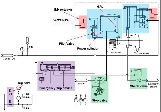

A servo system is designed to control the governing valve of the steam turbine precisely and quickly respond to loss-of-load or emergency. Precise and stable steam valve control directly relates to improved steam turbine speed and load control and reduced system mechanical wear. The conventional servo system is a combination of an E/H Actuator, pilot valve, power cylinder and a complex system of linkages which is used to operate steam turbine control valves.

Conventional Servo System[/caption]

E/H Actuator: An electrically controlled hydraulic amplifier/actuator which converts electrical signal to a proportional linear/rotary output shaft position to control the flow of steam to a prime mover.
Power Cylinder: A mechanical device which uses the hydraulic oil pressure to provide the necessary force in a linear motion required to operate the Governing valves.
Pilot Valve: A device used to supply hydraulic oil to the power cylinder depending on the movement of E/H Actuator linkages.
The electro-hydraulic actuator converts an electrical signal to linear/rotary shaft output which can be used to drive a steam valve but the required force to move a steam valve is often very high when compared to the output force of an actuator. Small condensate turbines typically don’t need the servo system and an E/H Actuator unit alone can provide the desired motion and force. In medium to large turbines, the E/H actuator alone is insufficient.
When a control signal to increase the steam flow is received by an E/H actuator, the actuator shaft moves in a pre-decided direction and causes movement in the pilot valve shaft. This drives the pilot valve to supply control oil to the power cylinder. The supplied oil creates a pressure difference across the piston of power cylinder which moves the GV linkage. The system of linkages forms a feedback loop which drives the pilot valve until the error between the desired actuator movement and position feedback is zero. The conventional servo also consists of a mechanical trip device which is capable of shutting down the turbine mechanically using a trip button in case of an emergency. A combination of piston, spring force and oil force acts as a set of three way valves. This is used to quickly drain the control oil along with the solenoid valve.

Mechanical Trip Cartridge: A completely mechanical device with a trip button which can shut down the Turbine even if all the electronic equipment fails. It can be used with servo that uses control oil to provide the Actuating Force with the help of pilot valve and power cylinder.
