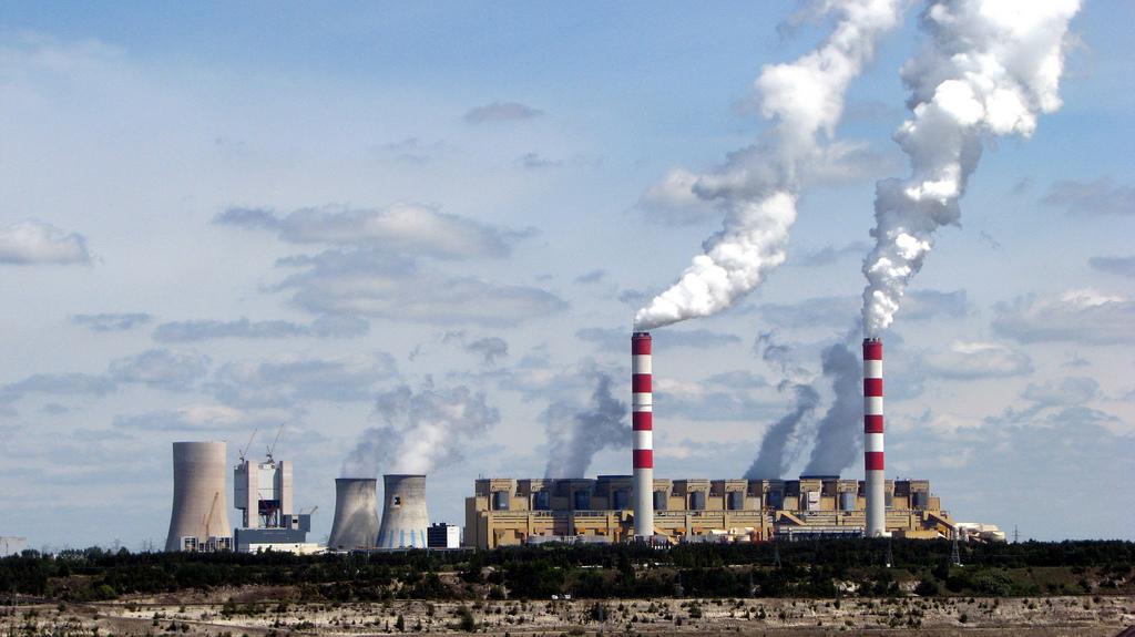

A recent study published in Environmental Research Letters suggests a new tactic for reducing global CO2 emissions – targeting the hyper-polluting power plant. The study, aptly named Reducing CO2 emissions by targeting the world’s hyper-polluting power plants, found that 17% to 49% of global electricity-based CO2 emissions could be eliminated using this approach.
