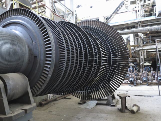

Many processes are available, including tank plating, thermal spray and selective plating. Tank plating immerses the components in a solution. To accomplish this, parts are typically removed and shipped to the plating company. Thermal spray, on the other hand, provides a mechanical bond. Once the spraying is done, machining is done to bring the component to the required dimension. Selective plating, also known as brush plating, is commonly applied via a handheld tool. The operator soaks the tool in the plating solution and applies it via an absorbent cover wrapped over the anode of the plating tool. It can be carried out in situ and creates an atomic bond.
Steam compressor housings and stages, for example, experience corrosion due to the build-up of condensation. Similarly, when leaks form in the seal areas of a turbine, pressure builds and steam releases at such high power, that it gouges or cuts any exposed component. Surface deterioration of metal components can lead to premature failure with the risk of unscheduled downtime. When a turbocompressor operates at full load, ensuring the correct dimensions of turbine shafts and housing covers is essential to optimal output. It is impossible to resist wear on these components, but there is a way to restore them to size with a nickel alloy without the need for post machining. The pinion gear is an essential part in a gear train assembly. If not maintained regularly, lubricant in the pinion gear can leak out of the seal, ultimately causing the bearing to seize and gall to the shaft. When the seized bearing is removed it can also remove excess material from the journal resulting in a gouge to the surface. Plating can prevent galling and raise surface hardness.
With many surface finishing options available, including thermal spray processes, IVD, PVD, tank plating and selective brush plating, choosing the right one for a particular application can be difficult. Selective plating, for example, is best suited for localized areas on inside and outside component diameters or flat surfaces. Take the case of rotor resizing. One major power generator uses selective plating for the maintenance of turbines. This saves it 50 per cent of the time required to return equipment to service. It builds up rotors with nickel to prevent erosion or wear on the shaft and permit optimal performance. Selective plating technicians use the OEM specification to determine the deposit to be plated and thickness required. If the shape is out of round or pitting has occurred, post machining is required. If only a small amount of deposit is needed, selective plating can be used to plate to size.
