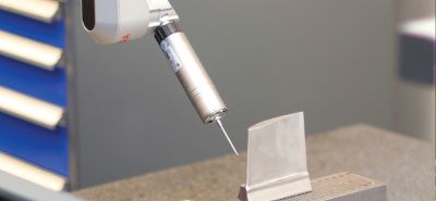

Blading Services Unlimited (BSU), an aftermarket manufacturer, focuses on producing new blading for all models of gas turbines, steam turbines, and compressors.
Rotating Machinery Services (RMS) recently acquired BSU, integrating the company with its own engineering, repair, and maintenance services on critical compression equipment. The collaboration with BSU brings together expert personnel and additional customer relationships, reinforcing RMS’ aftermarket upgrades, repair, maintenance, and rebuilding/overhaul services for turbomachinery.
BSU is an independent aftermarket turbine blade and parts manufacturer focused on producing new blading for all models of gas turbines, steam turbines, and compressors. It offers precision engineering, in-house tooling, quality assurance, and customer service, expanding RMS’ capabilities and providing customers access to high-quality blades.
