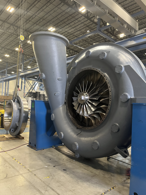

RMS performed a digital overlay using a real-time scanner to prepare for the virtual assembly process before replacing the blower.
Engineering and metrology teams at Rotating Machinery Services (RMS) performed a drop-in blower replacement on an AC Compressor-brand D54 centrifugal compressor. The teams scanned the current blower during operation at RMS’ Pearland Works facility, revealing critical geometries such as suction and discharge nozzles and baseplate feet without interfering with the customer’s production schedule.
"I am proud of our team's approach to the AC Compressor D54 centrifugal compressor replacement project," said Kraig Simpson, Vice President of Technology, RMS. "By leveraging advanced real-time scanning and virtual assembly technologies, we have not only streamlined the integration process but also set new benchmarks for efficiency and precision in the industry. This project exemplifies how we are changing the way we view turbomachinery maintenance, pushing the boundaries of what is possible and paving the way for more proactive, data-driven, and seamless maintenance solutions."
The digital overlay provided by the real-time scan prepared RMS for the virtual assembly process in the Prevu3D platform. A virtual overlay of the replacement blower was compared to the original scan data, allowing engineers to understand how the component would fit into the system upon installation. The scan comparison established the need for precise baseplate machining for a seamless fit on the new blower—RMS partnered with a field machining company to optimize baseplate geometry for efficient installation and optimal shaft end alignment.
Blower for D54 centrifugal compressor; Image Credits: RMS
The overlay also showed differences in discharge nozzle heights between the existing blower and the replacement part. Engineers used metrology data to fabricate a transition spool, addressing the height variation.
