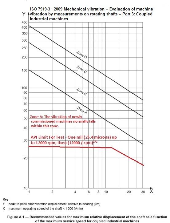

In the May/June 2015 issue of Turbomachinery International is an article on page 40, “Myth: We need more machinery standards”, by Klaus Brun of Southwest Research Institute & Rainer Kurz of Solar Turbines. Many standards may be too long that require digital access for searching terms. Moreover some specifications are too restrictive that adds unnecessary expense for all manufactures and thus cost for all. As stated to the writer by one vendor: "While manufacturers are capable of meeting the existing vibration standards, tighter tolerances always come at a cost.  The limits are unevenly applied due to a focus on 25 micrometers (one mil) displacement, which is at odds with how alarms and trips are set.  Field alarms and trips are based on a displacement that is inversely proportional to the square root of the speed per ISO 7919; in essence proportional to the square root of 12000/N.  Therefore, the slower the speed, the higher the margin when leaving the factory."

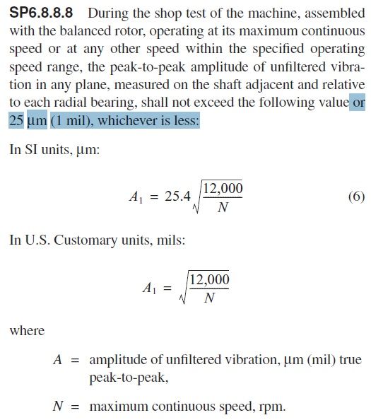

The marked-up figure from ISO 7919 shows the disparity with the limit given in Reference 1, page 5-13, API standard paragraph SP6.8.8.8.

API standard paragraph from API 684 – reference 1 - limits shaft vibration as shown below.
https://turbomachinerymag.com/wp-content/uploads/2015/08/API2061720Vibration20Limit-1.jpg

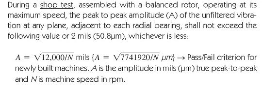

The original API specification for shaft vibration limit used the equation (12000 / RPM)1/2 and did not have the restriction:
“…or 25 µm, (1 mil), or whichever is less.”
Amplitude limit was lowered from two mils to one mil because of issues due to combinations of factors over the years, and users wanted low levels of vibration for plant start up issues. The original equation is also recommended by Perez and Conkey in Reference 2:

Perez and Conkey also note in reference 2: “Once a machine is installed in the field, a different vibration evaluation criterion is normally applied to take into account real-world effects, such as normal wear, piping strain, rotor fouling, etc.”

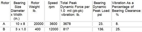

Vibration alarm and trip values in field operation are much higher for a machine running at 3600 rpm than for one at 12000 rpm. Thus a one mil limit during acceptance test or during initial field conditions is too restrictive for heavier rotors at lower speeds as shown below.
Dynamics of machinery should be based on velocity limits - not pure displacement. The relative dynamic loads on bearings and other components are also a function of speed. The original API equation, (12000 / rpm)1/2  at least gets closer to a velocity basis. For example, a machine running at 3600 rpm versus one running at 12000 rpm will have much lower relative dynamic loads and potential for seal rubbing with one mil vibration of the entire rotor:
https://turbomachinerymag.com/wp-content/uploads/2015/08/Vibration20Level20Comparison20-20360020vs201200020rpm-A_0-1.jpg
This assumes the entire rotor is vibrating at one mil (pk-pk) and rotor force is directly transmitted to the two bearings. In actuality rotor mode shapes / oil films will change dynamic load, but real unbalance response cases that calculate forces transmitted to bearings will give similar results.
