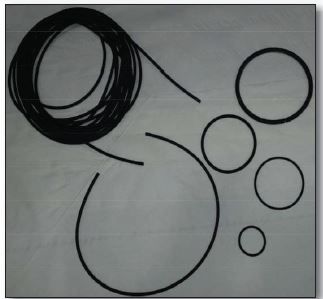

One of the most widely adopted forms for elastomeric sealing devices is a circular cross-section chord that is produced in a solid annular ring format commonly referred to as the O-ring (Figure 1). The Oring has a circular cross section that can also be pressed into irregular profiles.

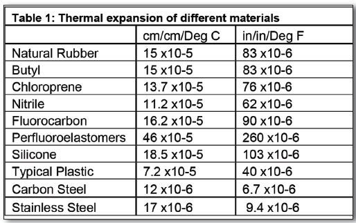

However, the coefficient of thermal expansion of elastomers is far greater than that of most other engineering materials (e.g., steel) so the additional groove volume is necessary to accommodate any increase in temperature or expansion of the O-ring.
Thermal expansion of different materials

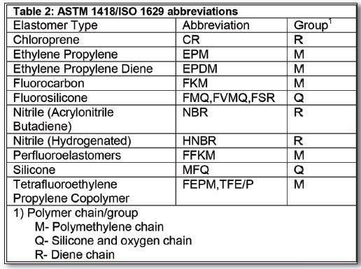

ASTIM 1418/ISO 1629 abbreviations
Table 1 highlights the amount of expansion normally experienced by various materials. There are many material types used for elastomers that are usually categorized into standard groups that identify the base materials whereby several characteristics are common to elastomeric materials (Table 2).

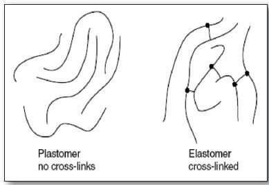

Most elastomers consist of a long chain of molecules that contain a repeating monomer (a molecule that can be bonded to other identical molecules to form a polymer) pattern. These long chains give elastomers the ability to stretch to many times their original length. Polymer chains on their own are relatively weak, so these chains need to be crosslinked to increase strength via curing agents added to the base material.
The base material (left) is shown prior to processing. Crosslinking
Figure 2: The base material (left) is shown prior to processing. Crosslinking (right) provides improved properties[/caption]
Other substances can be added to change material properties such as fillers and processing aids (Figure 2). Molding techniques, temperature, time and power consumption also influence elastomer properties. Probably the most common elastomeric sealing material used in the oil and gas turbomachinery industry is the fluorine-based fluoroelastomer (FKM).

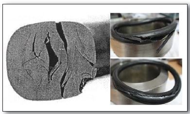

Explosive decompression (ED) occurs to elastomers when gases are absorbed into the material through pressure and retained within the material until the system is depressurized. These retained gases expand rapidly causing blistering and mechanical damage (Figure 3). The extent is dependent upon factors such as sealed pressure, decompression rate, the gas itself and material properties. ED, also known as rapid gas decompression (RGD), is largely related to material tear strength.
Figure 3: Typical ED damage internal (left) and external (right)
Figure 3: Typical ED damage internal (left) and external (right)[/caption]
This dictates the ability to resist cracks from regions that are highly stressed during decompression. Pockets of trapped gas induce stress within the material void. Elastomers with high tensile strength and high tear strength tend to resist such damage more readily. However, this comes at the expense of flexibility and resilience.

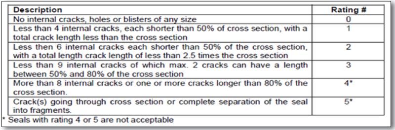

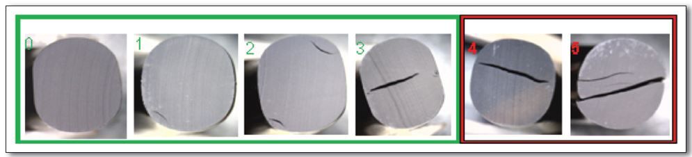

In fact, the damage-rating system is based on a numerical ranking from 0 to 5. The rating scores the condition of the material contained within a cut section where four cuts are usually done per specimen. The position of the cut and the manner in which the material is divided alter results. A 4 or 5 grade signifies failure, however there is significant damage to O-rings with a 3 rating (Table 3 and Figure 4).
