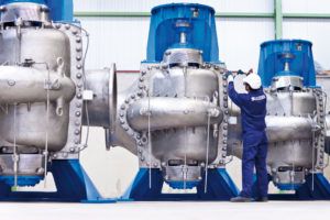

In some situations, the specification of a centrifugal pumping system will involve multiple pumps, either in parallel or series configurations. This enables smaller pumps to deliver much greater flow or head, depending on the pump arrangement, which may be preferable to a large single pump.

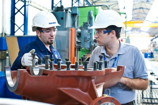

When working with pumps in series, it is important to understand that although the pumps may be hydraulically the same, designs may be different. Any pump located upstream of the initial pump will be operating at a higher pressure. Castings, shaft diameter and pipework will need to be correctly rated for the higher pressure.
