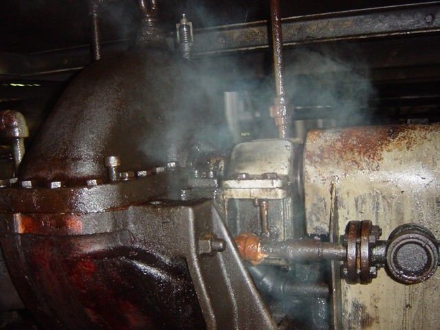

It is not unusual for large oil refineries to have 160 general purpose (GP) steam turbines installed at a major site. Return-on-investment (ROI) studies and related cost assessments indicate that major refineries may have opportunities to capture steam turbinerelated corporate-wide maintenance savings in excess of $3,000,000 annually. The two areas worth exploring are bearing protector seals and cartridge-style steam glands wherein high temperature mechanical seals replace the century-old segmented carbon ring technology. These issues are of great importance to reliability- focused refineries, fertilizer producers and petrochemical plants to prevent steam from entering the bearing house (Figure 1).

Lubricating oil can become contaminated by steam blowing past the carbon rings in the shaft glands. The contaminated oil requires periodic discarding and must be replaced by fresh oil. As a precautionary activity, water must be drained off in an effort to extend bearing life and machine reliability. However, by the time free water collects and is visible in a sampling line or sight glass, dissolved water will exist and often cause additives depletion through a process called partitioning.

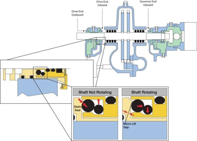

Replaceable rotating labyrinth devices can be installed in existing machines without bearing housing modifications. Unlike traditional fixed labyrinths, they use centrifugal force to expel potential contaminants before they reach the oil. During periods of operational idleness dynamic (axially moving) vapor-blocking O-rings provide a secondary level of protection and compliance with the requirements in API-611, paragraph 6.10.4.2.1. Lubrication protection must be effective when the equipment is running and when not in operation. With traditional labyrinth seals, moisture aspiration occurs. As the equipment cools, the surrounding ambient air is drawn into the bearing housing.
To prevent moisture ingress, a vapor shut-off device is needed. This shut-off feature is often overlooked in seal designs. A well-engineered bearing housing seal prevents moisture ingress. Temperature resistance is achieved by using graphite foil secondary shaft seals (Figure 2).
Figure 2: Location of bearing housing protector seals. Note the large cross-section O-ring which seals against a static seat if the shaft is stopped and provides an axial micro-gap with shaft operating.
