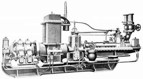

In 1894, Parsons got control of his parallel flow patents again and immediately dropped the development of the other types of turbines. He started again where he had left off five years earlier. The time was ripe for the steam turbine to take off all around the World and Parsons led the way. He started licensing his patent rights and designs to a number of companies including those in France, Germany, Switzerland, the United States as well as others. One of the first steam turbines he made in 1894 at the Heaton Works was a non-condensing 350 KW turbine with a dummy piston at one end to balance pressure and had the new airfoil designed blading. It ran at 3000 RPM to drive a 50 cycle AC generator.
Parson had designed a condensing turbine to go with the new stepped rotor high pressure 75 KW unit in 1889, but it was not built until 12 years later. The steam entered each end of the rotor to balance the pressure and exited at the center to the condenser. He used the new stepped casing/rotor design for better expansion velocities. It was sold to Newcastle and District Electric Lighting Company to go with the existing 75 KW non-condensing unit.
In 1902, Parsons made another improvement for his beloved steam turbines by finding a way to get the leakage air out of the condenser and keeping it out so that a much higher vacuum could be realized to improve the efficiency of the condensing end of the steam turbine. He came up with the vacuum augmenter system that sucked out the non-condensable air to improve steam turbine efficiency. This turned out to be a very important advancement as were many of his other ideas he fostered while in exile.
The use of electricity in 1900 started to surged and to take care of this sky rocketing demand of AC power, Parsons took on the task of designing and making larger and larger steam turbine generator sets using all of the improvements he had developed as a lame duck. Since 1900 the size had risen from 500 to over 6000 KW in ten years.
