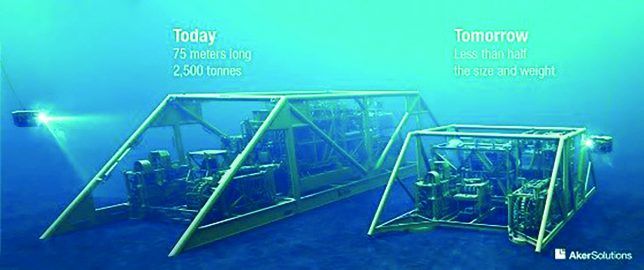

The initial subsea compression system, as implemented for the Åsgard license, experienced high costs due to a multitude of non-reoccurring technology development and qualification activities and a conservative production layout that increased system complexity.
However, many current development and qualification activities are addressing subsea system complexity, footprint and cost issues.
Wellstream, or wet gas, compression can reduce complexity by removing the need for large suction scrubbers and a subsea pump with its associated power system and umbilical (Figure 1). Full-scale simulated wellstream operation tests with existing subsea compressors showed that only 4% additional power is needed for 19% additional liquid mass flow rate.

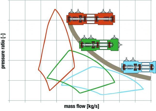

single-overhung
Figure 2: Single (blue), overhung (green) and tandem (red) HOFIM modularity options for a range of production requirements
Additional wet gas tests showed that higher pressure ratios can be achieved compared to dry gas compression, thereby enhancing compressor performance. This multiphase performance gain combined with its compact modular compression configuration options (Figure 2) offer a cost and performance benefit over the wide range of production requirements an offshore field can experience over its lifetime.
