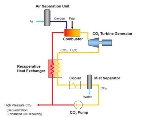

The new thermal power plant uses a supercritical CO2 working fluid to produce low-cost electricity while cutting emissions of nitrogen oxides (NOx), CO2 and other pollutants. CO2 is separated and collected at high-pressure without requiring additional carbon capture equipment or processes, enabling full carbon capture without increasing the cost of electricity.

The system operates at a high pressure of 300 atmospheres, and the development of its key equipment – a new combustor and its related turbine – was a critical challenge. Toshiba met that challenge by applying its high-temperature, high-pressure combustion and cooling technologies to the design, development and manufacture of a novel, supercritical CO2 combustor and turbine for the power system.
Last month, the test program broke new scientific ground by confirming stable operation at the system's target pressure of 300 atmospheres, fully confirming Toshiba's design. The recent successful testing of the combustor is a major step towards the realization of this disruptive power system, and Toshiba will continue testing to generate additional new data while further demonstrating the operability of the combustor.
