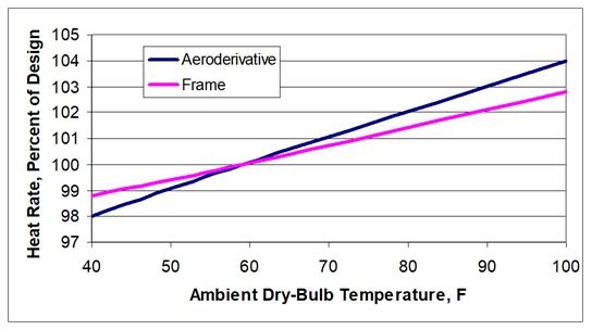

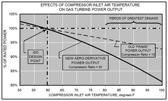

Air density impacts the performance of all gas turbines. Air density changes with changes in air temperature, humidity, and atmospheric pressure. Therefore, all GTs are rated at a standard set of ambient conditions. International Standards Organization (ISO)’s standard 3977-2 is used for rating GTs. It defines standard ambient conditions as 59oF, 60% relative humidity, and atmospheric pressure at sea level.An increase in ambient temperature has the most impact on decreasing the air density and performance of GTs. Increase in ambient temperature also increases demand for electric power due to increased use of air conditioning equipment in buildings. Increased demand for electric power results in increased market price of electric energy.
Unfortunately, increase in ambient temperature reduces the output capacity and the efficiency of GT systems, just when electric power demand and electric energy prices are high. The extent of the impact of increased temperature varies with the GT design. Some examples of the effect of ambient temperature on the output capacity and heat rate of GTs are shown in Figures 1 and 2, respectively. Increase in ambient temperature not only reduces the electric output of the gas turbine, it also reduces the mass flow rate of its exhaust gas, though with a slight increase in the temperature of the exhaust gas. On an overall basis, the total thermal energy of the exhaust gas decreases with increase in ambient temperature. Since a combined-cycle system uses the GT exhaust gas to generate steam for operating a steam turbine, an increase in ambient temperature also reduces the output of the steam
Figure 1: Effect of Ambient Air Temperature on Power Output of Gas Turbines[/caption]
Figure 2: Effect of Ambient Air Temperature on Heat Rate of Gas Turbines[/caption]
