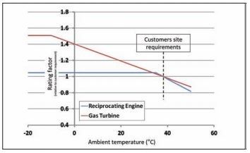

The prime movers (GTs or REs) for a plant produce a maximum power that is dependent upon the ambient temperature; this is defined by the rating line. Figure 1 shows example rating lines for a typical GT and RE, both drivers showing a “flat rating” region at lower ambient temperatures, although for the RE this occurs at a higher ambient temperature than for the GT.
15151
Figure 1: Power output vs. temperature showing rating line for GT and RE[/caption]
It is therefore important that the site’s power requirements are considered across the entire ambient temperature range. In most cases the limiting power will be at high ambient temperatures and hence particular focus should be given to operation in these conditions. The example rating curves in Figure 1 are shown for a site with a maximum ambient temperature of 38ºC. It can be seen that, with a GT, significant extra power can be generated at lower ambient temperatures. In many grid type applications this can be an advantage.
Rating lines are defined by mechanical or thermal limits. For the GT, maximum power is often defined by maximum component temperatures in the turbine (the sloping part of the rating line) and the shaft mechanical design or the generator frame size (the flat part of the rating line). For the RE, the power is often defined by the maximum allowable cooling water temperature (sloping line) and the shaft mechanical design or the generator frame size (flat line).

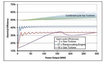

Figure 2 shows examples of efficiencies for multiple small GTs and REs, and single or dual gas turbines with and without combined cycle. The highest electrical efficiencies are achieved by GTs in combined cycle configuration.
Even with smaller GTs in combined cycle configuration, electrical efficiencies in excess of 50% can be achieved. Simple cycle RE electrical efficiency reaches 48% in some cases and, in a combined cycle configuration, this can be raised further without reaching the levels of GTCC. However, simple cycle GT efficiency is lower than REs; the most efficient GTs achieve about 40%.
One further factor has to be taken into account: the change in the power production mix is requiring gas-fueled power plants to be flexible and operate more frequently at part load. In Figure 2, multiple unit plants at part load have an advantage in efficiency over single- or dual-unit GT plants.
