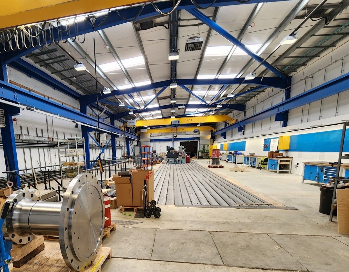

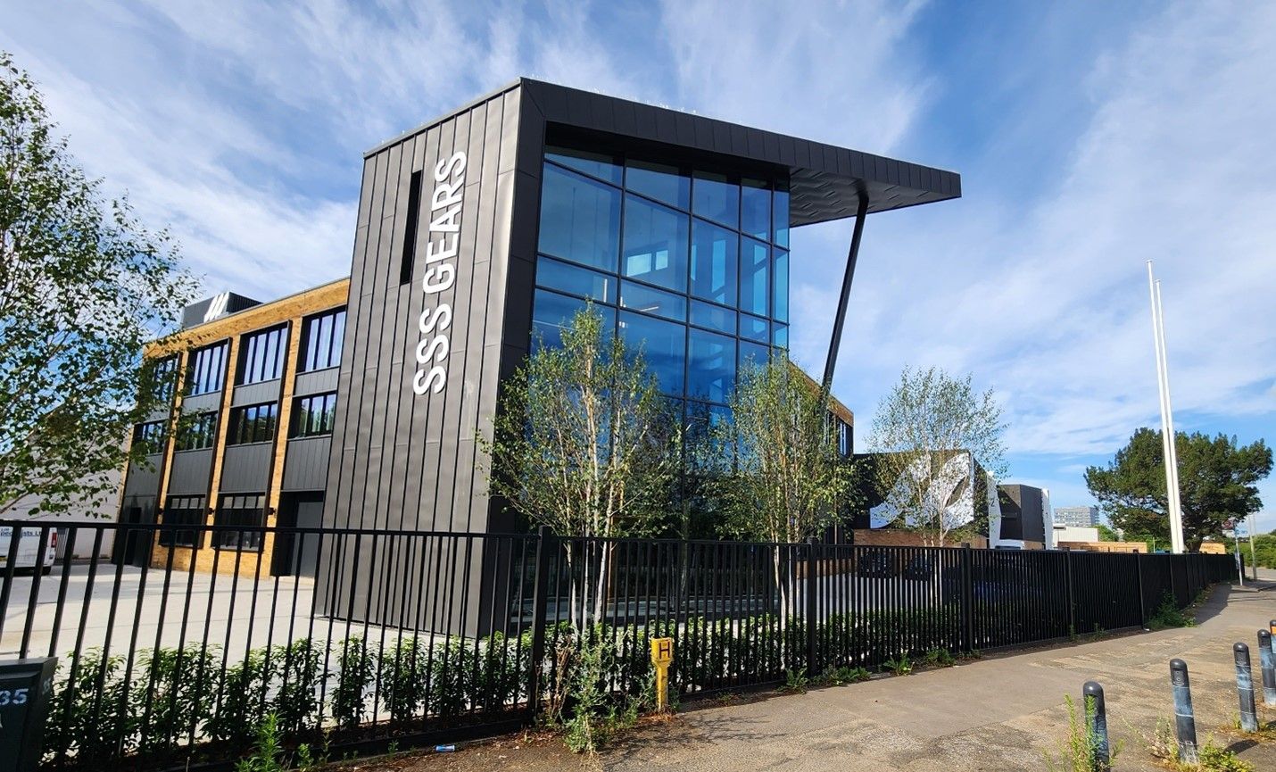

To increase capacity, the factory next door was acquired. Demolition and rebuilding the previous site—a five-year process—created a modern customized workshop, a high-power test facility, and offices. This facility doubles the manufacturing area to more than 60,000 square feet. Full operation commenced in 2023.
SSS Gears newly opened facilities near London.

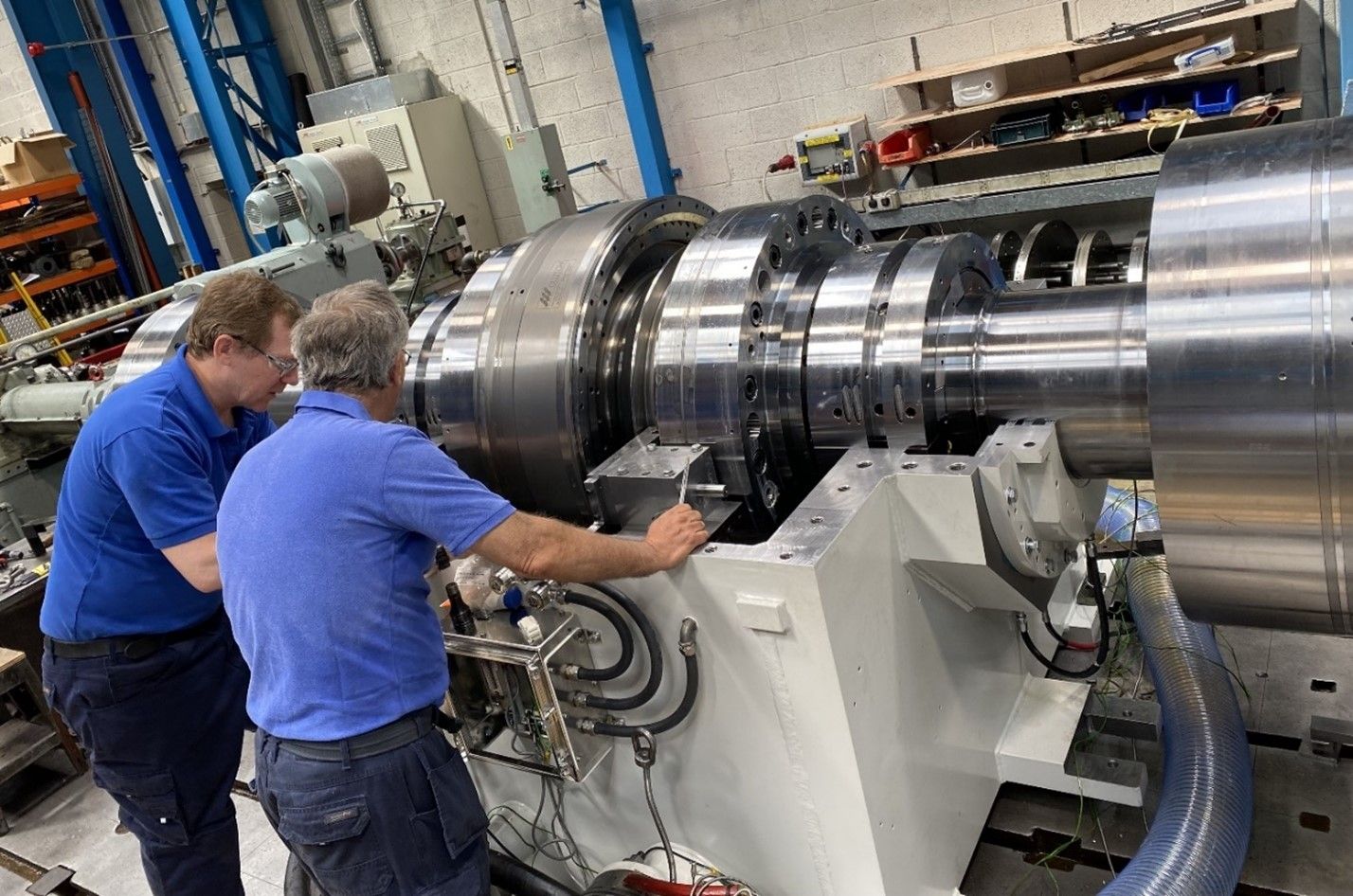

During the tour, a 300 MW unit was on the test stand. It takes several days to set up and test a machine of this size. During the facility upgrade, additional power was added to the workshop to test even bigger clutches, engaging and disengaging them, and rotating them at the speeds at which they would operate when installed. Crane capacity was boosted to handle these larger, heavier assemblies and the increased assembly area provides more working area for these large parts as well as short-term storage until they are inspected and approved for assembly.
SSS Gears now has a test rig capable of testing clutches as large as 400 MW.

SSS technicians setting up large clutch test.
