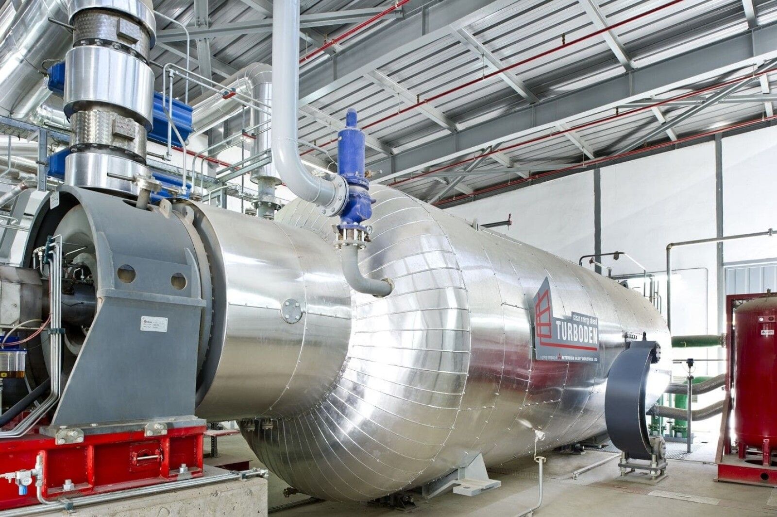

A subsidiary of Mitsubishi Heavy Industries, Turboden America, obtained a Phase II award for Fervo Energy’s Cape Station geothermal project in Utah. Turboden will deliver equipment for three 60-MWe Organic Rankine Cycle (ORC) units, totaling 180 MW of clean dispatchable power. With an additional three Gen-2 units, Turboden’s technology will generate 300 MWe of power at the Cape Station site, forming one of the largest geothermal installations globally.
“We are honored to deepen our collaboration with Fervo Energy and contribute to the next chapter of Cape Station,” said Paolo Bertuzzi, CEO of Turboden. “This new order further validates the reliability and scalability of our ORC technology and reflects the strength of our partnership with Fervo Energy in next-generation geothermal. With Turboden America now fully operational, we are positioned to support large-scale projects and foster closer collaboration with our U.S. partners.”
Cape Station’s Phase II engineering and procurement scope includes Turboden’s turbines and control system, which are scheduled for delivery and commission by 2028. Also, this award follows the company’s ORC delivery for Cape Station Phase I—soon to be commissioned in 2026. These units represent the second generation of Fervo’s modular power plant design, marking a significant milestone in the large-scale implementation of enhanced geothermal systems.
The project features 500 MW of under-development geothermal energy, obtaining 120 MWe of Gen-1 ORC equipment from Turboden in Phase 1. Since October 2024, Turboden America LLC has been fully operational and helping to provide 24/7 carbon-free energy to the grid.
ORC unit | Image Credit: Turboden
