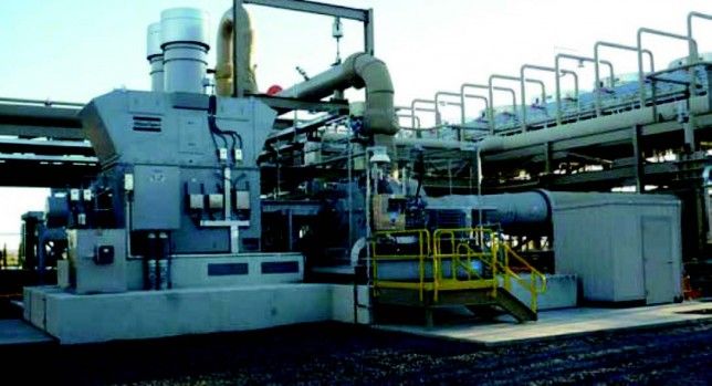

Figure 1: This 14.5 MW turboexpander deployed in a low-temperature geothermal plant takes advantage of Organic Rankine Cycle (ORC) technology for converting heat to electric power
The radial inflow turboexpander or expander is widely used in the hydrocarbon processing industry. The most common applications include natural gas processing for natural gas liquid (NGL) recovery; petrochemical refrigeration in ethylene, propylene, and ammonia production; cryogenic recovery of refinery off-gas; and production of liquefied natural gas (LNG). The expander has also found a good fit in power recovery applications, including Organic Rankine Cycle (ORC) heat-to-power using geothermal heat or industrial waste heat, and in natural gas pressure letdown (Figure 1).

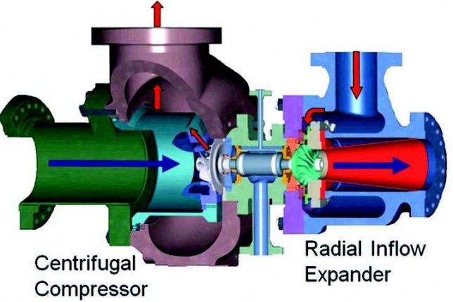

Expanders produce shaft torque and refrigeration from their nearly isentropic expansion of gas, liquid or even supercritical fluid. The torque can be usefully recovered to drive an integral compressor, an external compressor, or an electric generator. The expander inlet fluid must be single phase, but the outlet can be two-phase. As an example, expanders in natural gas processing have been running for more than 20 years that handle condensing vapor with up to 50% liquid by weight at the discharge. By the early 1970’s all new air separation plants were built using centrifugal expander-compressor (EC) units. A modern EC unit is shown in Figure 2.
The expander is equipped with variable inlet guide vanes. The vanes can be actuated externally and used like a control valve to maintain upstream or downstream pressure. EC units are supplied as complete skidded packages including lube oil system, seal gas system, and instrumentation and control systems.

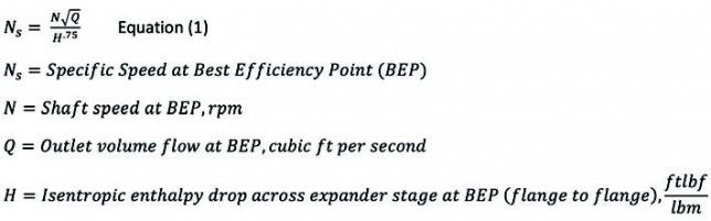

Since the purpose of the expander is to produce refrigeration, it is important for the aerodynamic design to be optimized for high efficiency in the expected operating range. To achieve high expander efficiency, it is important to match the rotor speed and wheel diameter to the isentropic enthalpy drop while matching the blade height and inlet guide vane area to the volume flow. This is accomplished by the OEM expander supplier by using two dimensionless parameters. The first is specific speed, which is defined in Equation 1 below.
The expander OEM does not control Q or H, since these parameters are set by the process design team. The laws of physics determine the optimum value for Specific Speed, and so the only variable remaining for the expander OEM is N, the design speed of the expander. For highest efficiency, N is selected so that the design point value for specific speed should be between 60 and 90.

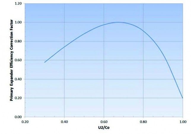

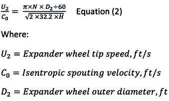

The second parameter is known as the “tip speed to spouting velocity ratio”: For highest efficiency, the value of U2/Co at design point should be between 0.65 and 0.72 (Figure 3).
Using the speed (N) calculated from the specific speed equation, the expander OEM uses Equation 2 to calculate the optimum expander wheel diameter. Note that a higher value for N at BEP results in a smaller value for D2 at BEP.
The expander efficiency at the BEP is determined from the specific speed relationship. If the value ofU2/Co is in the peak range, then no additional efficiency correction is required. Figure 3 can be used to determine the efficiency multiplier for operation away from optimum U2/Co.

Figure 2: Expander-Compressor cross section
The primary role of the compressor wheel at BEP process conditions is to act as a brake so that the expander wheel will run at its optimum speed N, producing highest efficiency and greatest refrigeration. The secondary role is to efficiently convert the incoming expander power into compressor boost so that the compressor power elsewhere in the process can be reduced.
The process design engineering team determines the compressor inlet flow, and the power coming from the expander determines the compressor input head. The compressor stage efficiency determines the pressure rise that can be achieved from the input head.

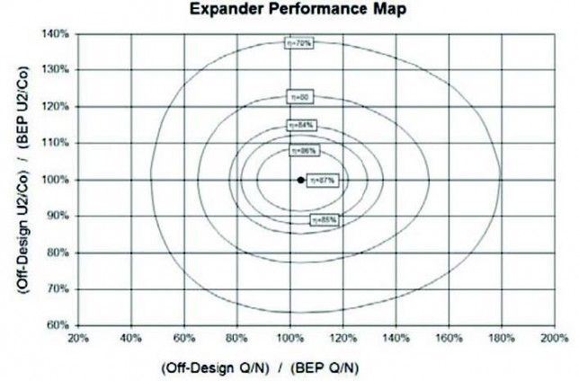

The two expander off-design parameters Q/N and U2/Co can be combined into shown in Figure 4.

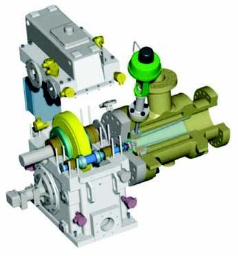

Since the optimum expander speed is usually well above electric generator speed, a gearbox is used for power recovery applications. For the past twenty years, the most common configuration uses an integrally geared solution, where the expander stage is mounted directly on the gearbox pinion shaft, eliminating the need for a high speed coupling and for separate expander bearings (Figure 5).
Turboexpander figure 5
Figure 5: In an integrally geared design, the expander stage is mounted directly on the gearbox pinion shaft, eliminating the need for a high-speed coupling or for separate expander bearings.
Shaft sealing can include labyrinth seals, oil film seals or dry gas mechanical seals. For higher pressure drops, the gearbox can be configured with two or more pinions, so that each expander wheel can run at its optimum speed. For higher flow rates, the gearbox can be configured with two pinions each having identical expanders piped in parallel, allowing the use of a single electric generator. Geothermal expanders producing 27,000 kW (36,000 HP) of electric power in a single power train are in service.
The ORC is used in converting heat to electric power when the heat source temperatures are too low for steam, or whenever installing and operating steam boilers is undesirable. The most common uses are in low temperature geothermal resources, where the hydrothermal water is used to boil a working fluid such as butane, propane, pentane, or R-134a in a closed cycle. An installed unit rated for 14.5 MW is shown in Figure 1.

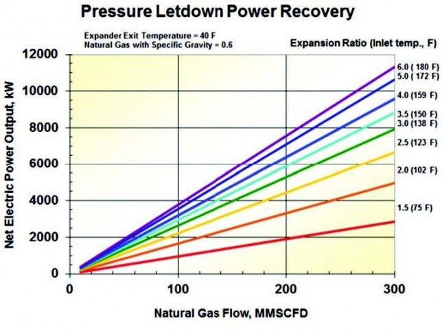

Natural gas distribution systems use pressure reduction stations whenever a significant pressure change occurs between a higher and lower pressure pipeline. Expanders have been installed in parallel with the existing regulator or control valve in order to produce useful power from this pressure letdown. Figure 6 shows the power available as a function of flow and expansion ratio. It also shows the minimum pre-heat temperature required to avoid possible hydrate formation downstream of the expander discharge.
