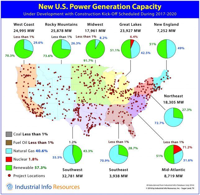

Figure 1: Renewables and natural gas generation are virtually the only two sources of new electric generation that are expected to be built between 2017 and 2021
Project development data tracked by Industrial Info Resources (IIR) sees renewable energy and natural gas dominating the new-build power market between 2017 and 2021.
In fact, the map of U.S. power development has gotten even greener over the last year, with renewable energy expected to account for about 57.3% of all new-build project activity for the next five years, up from 55.3% for the 2016-2020 period. Gas-fired generation is projected to account for about 40.6% of all new electric generating capacity that will be built between 2017 and 2021. The regions with the greatest concentration of renewable energy development over 2017-2021 are the Midwest (where renewables are projected to account for 91.8% of all new-build generating capacity), the Rocky Mountains (73.6%, down a touch since last year) and the West Coast (70.3% of all new-build generation project activity).
By contrast, the Northeast and the Southwest are expected to see the least amount of renewable power project development over the coming five years. Both regions have largely tied their fates to natural gas, though in the Northeast it remains an open question whether the necessary gas pipeline infrastructure can be built in time to meet projected demand growth. New power project development has become a two-fuel race in the several regions, with gas and renewables being the only fuels in contention. The Midwest is split 92% to 8% between renewables and gas while in New England the split is much closer, 51% to 49%.
In the Northeast, gas-fired power development leads 73% to 27%. In the Rocky Mountains, new-build coal has a tiny slice of the project development market, which is otherwise dominated by renewable energy over natural gas, 73.6% to 26.3%. Coal interests have long seen energy and environmental rulemakings as a “war on coal.” But low-priced natural gas, congressionally backed incentives for renewable energy and state regulatory mandates to increase renewable energy, distributed energy (typically rooftop solar) and energy efficiency, also played key roles in dethroning King Coal as the leading fuel for electric generation in recent years.
