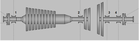

Siemens Energy’s SGT-600 gas turbine consists of two main sections: gas generator (GG) and power turbine (PT). The two main sections are not mechanically interconnected.
- The GG comprises an axial-flow air compressor, combustion chamber, and compressor turbine. The axial-flow compressor and compressor turbine have 10 stages and two stages, respectively. The GG rotor is supported by two journal bearings.
- The PT consists of a turbine with two stages. Its rotor is supported on two journal bearings.

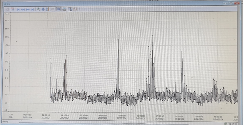

In the refinery, the SGT-600 gas turbines drive methane export compressors. These compressors transfer methane to the Iranian Gas Trunk (IGAT) line. In recent months, bearing No. 2’s vibration level had relatively increased in one of the gas turbines to a minimum magnitude between 6 mm/s rms and 7 mm/s rms; its maximum level reached up to 12 mm/s rms. The alarm and trip limits were 7 mm/s rms and 15 mm/s rms, respectively (FIGURE 2).
FIGURE 2 shows the vibration levels increased sharply within one to two hours and then decreased sharply. There were no significant changes in operating speed, pressure, or other process parameters. The following factors impeded an accurate picture of the dynamic and vibration behaviors that were occurring during sharp vibration changes:

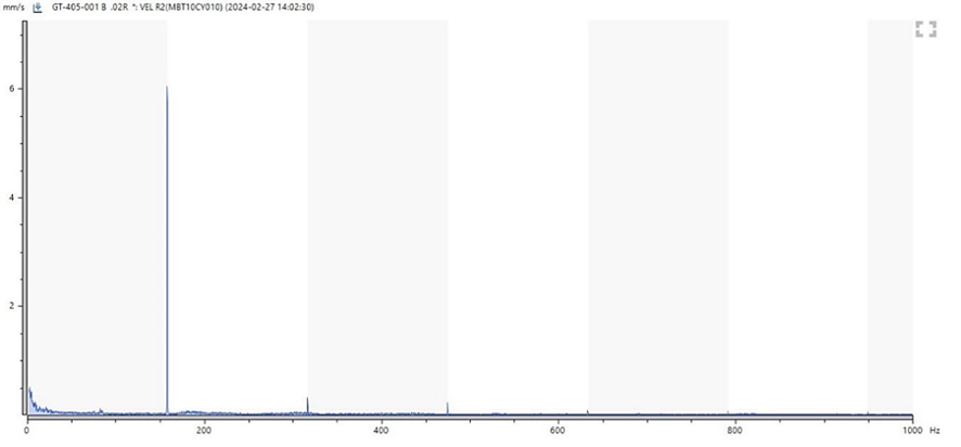

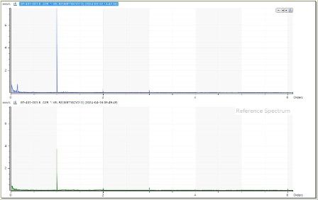

Therefore, the only way to analyze vibration characteristics was the frequency spectrum from the accelerometer installed on the bearing (FIGURE 3).
As seen in FIGURE 3, the dominant peak is at rotational speed, i.e., 1X, a primary sign of unbalance. Due to the lack of another accelerometer and the inability to perform orbit and phase analyses, a definitive conclusion could not be drawn. However, if the unbalance was the only problem, the vibration levels would continuously be high and not have severe fluctuations, which means a more significant factor affected the bearing’s vibration. To obtain more information, the oil was analyzed.

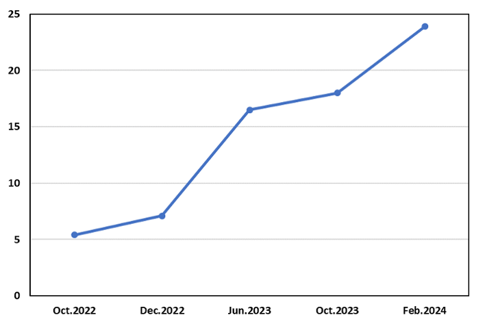

An oil analysis revealed a rising trend in the membrane patch colorimetry (MPC) test (FIGURE 4), indicating the onset of oil degradation.
As varnish forms, particles gradually deposit on metal surfaces and cause issues, particularly in low-clearance areas. MPC had increased in the past 18 months, providing sufficient time for varnish deposits to form on the shaft, bearings pads, and labyrinth seals. Since bearing No. 2 is close to the combustion chamber, it receives the highest heat. Consequently, oil in this bearing is more exposed to thermal degradation, so varnish formation is more probable than in other bearings.

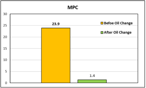

An oil flush was performed, and after, the oil was changed. After start-up, an oil sample was taken and the oil condition, especially the MPC parameter, was evaluated. The oil analysis showed a significant decrease in the MPC level from 23.9 to 1.4 (FIGURE 6).

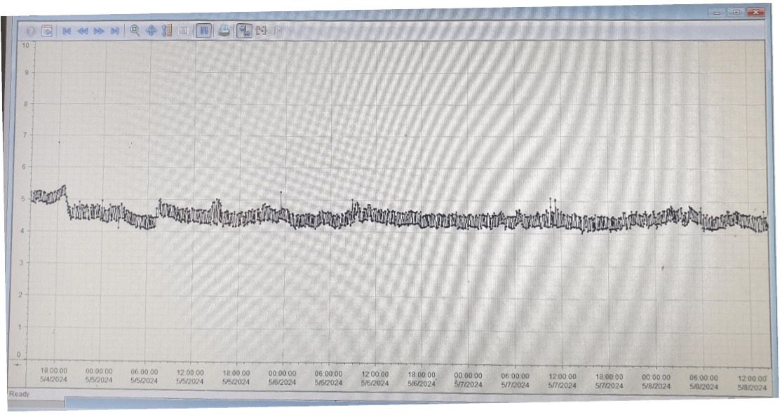

FIGURES 7 and 8 show a trend of vibration and frequency spectra of the bearing (before and after the oil change), respectively. The bearing’s vibration significantly decreased after the oil change, fluctuating between 4 mm/s rms and 5 mm/s rms, which is an acceptable range. This proves the hypothesis that varnish caused the increased vibrations.
