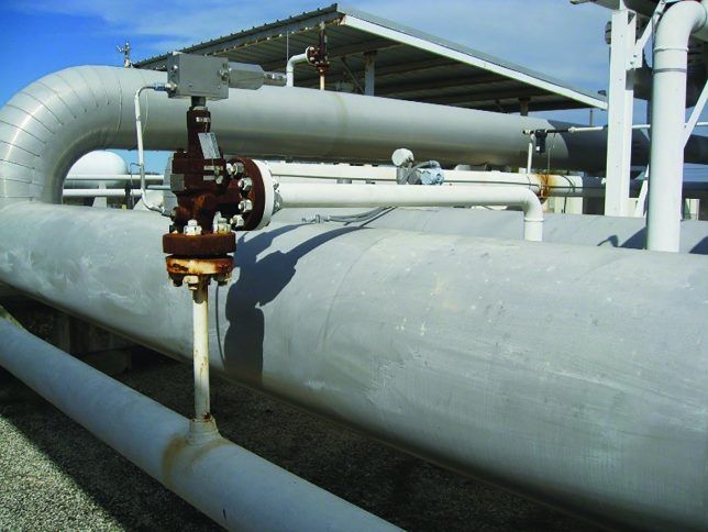

Figure: Small bore piping in the vicinity of turbomachinery can suffer from
vibration problems
Small diameter branch connections often develop vibration related fatigue failures due to mechanical excitation. Many installations do not design small diameter piping to avoid this issue. However, the risk of fatigue failure of small diameter branch connections (SBCs) can be reduced using two alternative guidelines developed by the Energy Institute (EI), and Pipeline Research Council International (PRCI)/Gas Machinery Research Council (GMRC).

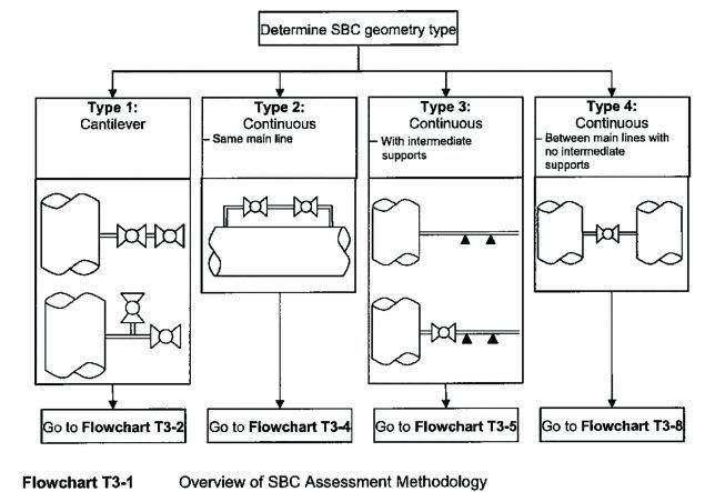

Figure 1: SBC geometry types used in the EI guideline
The EI guideline categorizes branch lines into four main categories (Figure 1): • Configuration 1 – Cantilever type
• Configuration 2 – Continuous—in and out same main line
• Configuration 3 – Continuous—with intermediate supports
• Configuration 4 – Continuous— between different main lines (with no intermediate supports)
The flowcharts in the EI guideline can be used as a broad-based screening criterion in the design phase of most SBCs to determine which are at risk of vibration. Weights are given to various characteristics to evaluate its susceptibility to vibration and fatigue.

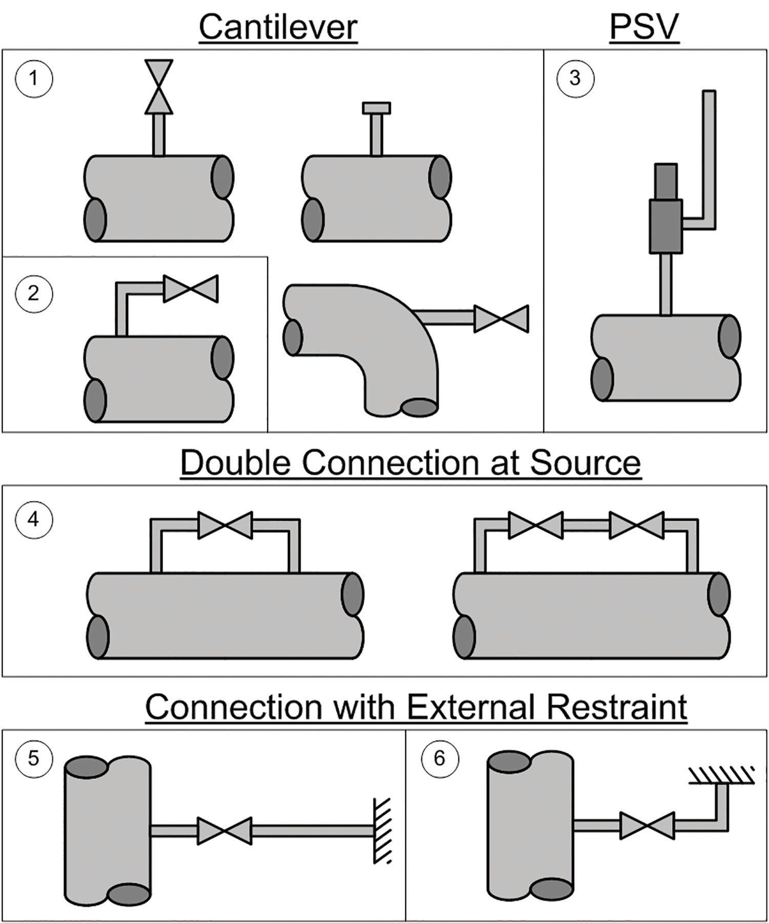

The PRCI/GMRC guideline provides recommendations for branch connections with nominal pipe diameters equal to or less than two inches, and where the nominal branch diameter to main pipe diameter ratio is less than 25%. It covers six different configurations (Figure 2).
https://www.turbomachinerymag.com/wp-content/uploads/2017/02/configurations.jpg
Figure 2: Various branch connection configurations covered by the
PRCI/GMRC guideline
• Configuration 1 – Straight cantilever
• Configuration 2 – Cantilever with elbow
• Configuration 3 – Pressure safety valve (PSV)
• Configuration 4 – Double connection at source
• Configuration 5 – Straight connection with external restraint
• Configuration 6 – Connection with external restraint with elbow
