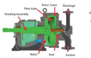

Coaxial arrangement[/caption]

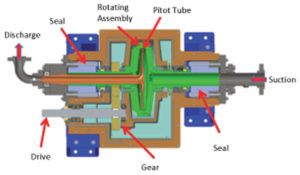

Flow-through arrangement[/caption]

A mechanical seal(s) is used to seal the rotating case. This seal(s) is exposed to only suction pressure. Besides the items required to support a rotating body (i.e. bearing frame and bearings), all pitot pumps are composed of three major parts. Two of these parts make up the rotating case; the rotor cover and rotor. The pitot tube is placed in the center of the rotating case, and has an opening facing opposite the direction of rotation near the periphery of the case. Fluid enters the opening where the tangential velocity is diffused into pressure and conveyed back to the center of the pump where it is discharged via the shaft supporting the pitot tube (Figures 1 and 2). Pitot tube pumps are most commonly available in either coaxial suction and discharge arrangement (Figure 1) or a flow through arrangement (Figure 2) where the suction and discharge are opposed. The important difference between the two is how the pitot tube penetrates the rotating case. In the coaxial arrangement, the pitot tube penetrates through the eye of rotor cover increasing the NPSHr, especially on light hydrocarbons. This arrangement is subject to hydraulic thrust; however, it requires only one seal.
The coaxial arrangement is typically offered as an overhung rotating case. In the flow through arrangement, the pitot tube penetrates the rotor. This decreases NPSHr and eliminates all hydraulic thrust. The flow through arrangement requires two seals and a tangential drive, this is typically accomplished via a gear drive. The flow through arrangement is typically offered as a between bearings rotating case. Pitot tube pumps typically operate at speeds above two pole motor speeds and require a speed increasing gearbox either mounted external or internal to the bearing frame.
