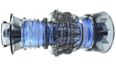

Jeffrey Goldmeer & Scot Peever of GE Power presented a paper on ethane in gas turbines at Power Gen International, 2015. Below are excerpts from the paper:
7FA_zoom_011
The search for suitable alternatives included a variety of fuels and has led to projects that may operate on a variety of fuels, including lean methane, non-methane hydrocarbons, crude oil, and syngas. The category of non-methane hydrocarbons now includes ethane and propane, which are becoming available in suitable quantities due to shale gas production in the US.

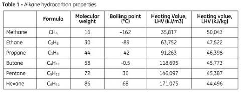

Flame holding can occur after flashback if the flame attaches or “anchors” to the fuel nozzle. As with flashback, this might cause damage to combustion hardware. Using higher molecular weight hydrocarbons, such as ethane, can create additional risks for flashback as the laminar flame speed (or the speed at which the flame propagates upstream into the unburned fuel) is higher than that of methane. Although the flame speed for ethane is similar to that of methane, the flame speed for propane and butane can be two times faster than methane.

Table 1 lead

In order to be able to use a new fuel in a gas turbine, it is important to understand fuel composition and key properties. In the case of a gaseous fuel, a detailed listing of the percent (by volume) of each constituent gas is required to determine the heating value, Modified Wobbe Index, as well as potential risks from contaminants such as hydrogen sulfide. This information allows the fuel to be properly matched to the appropriate combustion system.
