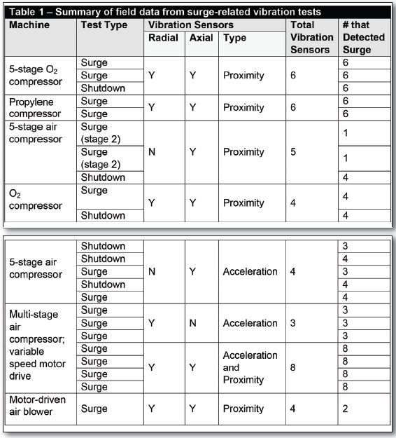

Depending on where vibration sensors are mounted, and the compressor stage at which stall and surge may be occurring, it is possible to observe a simultaneous rise in vibration. For example, 14 separate surge tests conducted across seven separate compressor trains showed a 100% correlation between vibration and surge, observed by almost every vibration sensor on the machine (Table 1).
Summary of field data from surge-related vibration tests

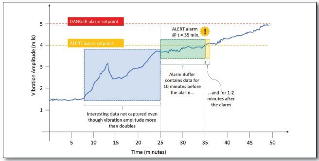

This method relies on a rolling buffer. It maintains a relatively high-resolution record of the last 10 minutes of vibration data. When no alarms occur, the oldest data is continuously overwritten by the new data. When an alarm occurs, the data in this buffer is frozen and saved, much as one might capture an intruder on surveillance camera by sensing when glass breaks on the front door and reviewing the video footage leading up to, during, and several minutes after the glass breakage.
Vibration systems work in similar fashion by waiting for a hardware alarm to occur from excessive vibration and saving about ten minutes of data leading up to the alarm, at the moment of alarm, and approximately two minutes after the alarm (Figure 2).
Figure 2: Alarm buffer data collection stores vibration data for a limited period prior to and after the alarm, but can miss significant changes in data that occur beneath the alarm setpoint. The data shown in the blue shaded area would be observable only as a limited resolution trend
only as a limited resolution trend[/caption]
However, there are several ways that data can fail to be captured. Most users only configure hardware alarms due to the tedium involved in tailoring software settings for each vibration point and parameter.
Two levels of hardware alarms (high and high-high) are typically present, but are generally set conservatively in order to not trip machine trains based on small changes in vibration.
It is not unusual for vibration levels in normal operation to be only 10% of alarm levels, such as a compressor set to alarm at 4 mils and trip at 5 mils of radial vibration, but running normally at 0.5 mils. In such a case, vibration amplitudes would need to increase by a factor of 8 for an alert and a factor of 10 for a trip, either of which would trigger a hardware alarm and freeze the corresponding alarm buffer.
Many vibration events do not incur sufficient change to trigger a hardware alarm. Surge-related vibration often falls into this category: significant enough to be of interest, but not of sufficient amplitude to trigger a hardware alarm or machine trip.
Another factor contributing to missed data is that although surge-related vibration often manifests as pronounced axial vibration rather than solely radial vibration, the thrust bearing monitoring on most machines is set to recognize only gross axial position changes, not axial vibration. Axial position monitors contain filtering that ignores the axial vibration component and responds only to the average axial position.
The alarm buffer method, therefore, often provides no useful data in a surge event because no relevant hardware alarms have been triggered. Trends may show elevated vibration levels, but waveform data is missing (the very data needed to distinguish surge-related vibration from other sources with similar characteristics and sub-synchronous frequency content such as axial and radial rubs, oil whirl, oil whip, and anything that causes re-excitation of the first balance resonance).

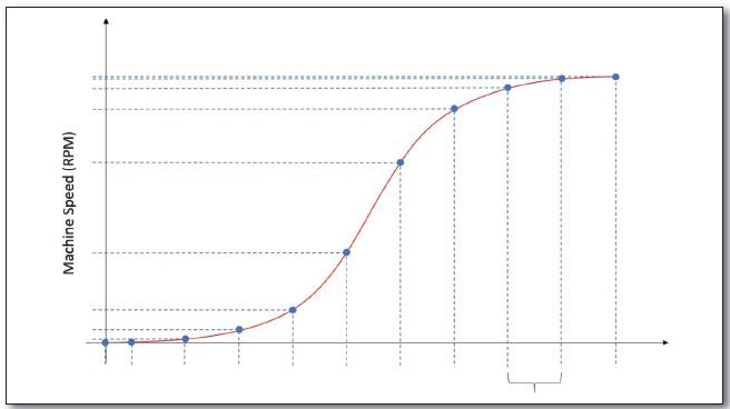

Delta-RPM collection
This mode collects data at preset rpm intervals. For example, the user may configure the system to collect a waveform (dynamic data) at 100 rpm intervals during a startup.
For a machine running at 6,000 rpm, a total of 60 waveforms would be collected during a startup. Static data is often collected at a 10:1 ratio, or in this case, once every 10 RPMs. Thus transient data is collected at relatively high resolution and when a surge-related event occurs during a startup or coast-down on machines for which ΔRPM data capture has been configured, it is usually caught.
Unfortunately, the times when surge is most often of interest are not during transient run-up or run-down conditions, but during steady-state speed operation when other process changes are occurring. These changes can lead to surge and may not be fully characterized in the surge-control algorithm, when supplemental vibration data to confirm a surge event can be most beneficial.

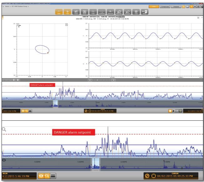

As the vibration system is recording these waveform attributes, the dead-band concept can be applied to waveforms. A baseline is stored along with sufficient attributes such as phase, amplitude, frequency content, gap voltage, period (speed) and the energy or amplitude within specific frequency bands.
Once a baseline waveform has been stored for every sensor, it is unnecessary to store each subsequent waveform. It is sufficient to compare every waveform to the baseline and discard if nothing has changed. Instead of hardware alarms, it relies on adaptive change percentages. The system can automatically identify interesting data and store data under changing speed conditions.
When it Shakes, it’s Saved
Figure 4, Figure 5
Figure 4 (TOP): Data collection based on “interestingness” is able to detect subtle changes in the waveform. Timeline at the bottom of the screen shows many meaningful “blips” in trend lines during a 10-minute segment of data, but none exceeded the alarm setpoint (shown by the red dashed line) and would not have been collected by systems relying on hardware (or software) alarm buffers. Orange vertical lines (Figure 5) show where waveforms were captured based on data interestingness. Data acquisition functions in this mode any time sufficient change occurs Figure 5 (BOTTOM): Enlarged portion of timeline from Figure 4 showing orange vertical lines in greater detail. Each one marks the instant in time where a waveform was stored and the height of each orange line is proportional to the waveform’s “interestingness” (i.e., its i-value) relative to the baseline waveform[/caption]
The latter approach makes use of the ivalue algorithm (i for interestingness) and has been present in a machinery protection and condition monitoring system developed in 2013. The data in Figures 4 and 5 are taken from a compressor train operating in a North American refinery. The algorithm can be adjusted as required, but work well for the majority of turbomachinery under factory settings. This technology helps ensure that when it shakes, it’s saved.

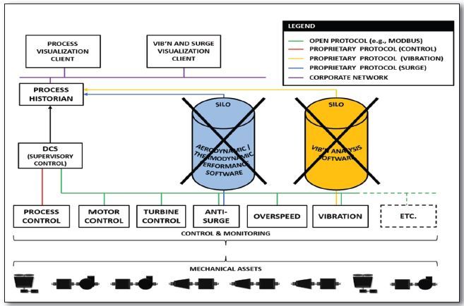

While part of the challenge is to save the data at the right times, a second challenge is to bring the data from disparate systems together. The logical place to do this is in the data historian, making it the single repository and allowing process, mechanical, thermodynamic and aerodynamic data to be correlated.
This eliminates the need for standalone data acquisition systems for vibration data, compressor performance data and surge analytics. Fortunately, the state-of-the-art has advanced sufficiently to allow the use of an off-the-shelf process historian. The OSIsoft PI System, for example, has the needed performance and data storage capabilities. This establishes a common repository and eliminates standalone information silos (Figure 6).
Figure 6: By using the process historian, IT infrastructure can be eliminated and all of the relevant data in the plant can reside in a single system of record. Data correlation between disparate sources allows for faster, more effective analysis and root cause determination
disparate sources allows for faster, more effective analysis and root cause determination[/caption]
