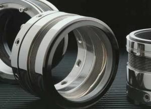

Why an ‘equivalent orifice’ must exist in gas seals
Close attention to a mechanical seal used in pump applications and a dry gas mechanical seal utilized for compressor applications will show reliefs of the rotating face of the seal.
Considering that both seals operate on a fluid may give some hint as to why the designs are so very similar. The objective of seal design is to positively minimize leakage while removing frictional heat, in order to obtain reliable, continuous operation of the seal. In a liquid application, the heat is removed by the fluid which passes between the stationary faces and the seal flush and changes from a liquid to gaseous state (heat of vaporization).
This is precisely why all seals are said to leak and explains the recent movement of the industry to seal-less pumps in toxic or flammable service. If the fluid between the rotating faces now becomes a gas, its capacity to absorb frictional heat is significantly less than that of a liquid. Therefore, an ‘equivalent orifice’ must continuously exist between the faces to reduce friction and allow a sufficient amount of fluid to pass and this take away the heat.
The problem obviously is how to obtain this ‘equivalent orifice’. There are many different designs of gas seals. However, regardless of the design, the dynamic action of the rotating face must create a dynamic opening face that will overcome the static closing forces acting on the seal to create an opening and hence ‘equivalent orifice’.
When rotating, the vanes create a high head, low flow, impeller that pumps gas into the area between the stationary and the rotating face, thereby increasing the pressure between the faces. When the pressure is greater than the static pressure holding the faces together, the faces will separate, thus forming an equivalent orifice. In this specific seal design, the annulus below the vanes forms a tight face such that under static (stationary) conditions, zero leakage can be obtained if the seal is properly pressure-balanced.
