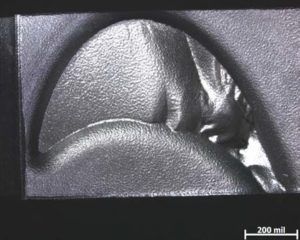

Blast cleaned steam turbine blade which removed all identifiable features[/caption]
