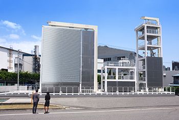

Caption: Desalination columns at the ENEOS Materials chemical plant. Credit: Yokogawa
In a 35-day field test, the AI solution demonstrated control over distillation operations previously managed manually by experienced personnel or by existing control methods (PID control/APC). Despite a scheduled plant shutdown for maintenance, the field test resumed. The AI proved capable of maintaining product quality and liquid levels in the distillation column, while optimizing the use of waste heat.
