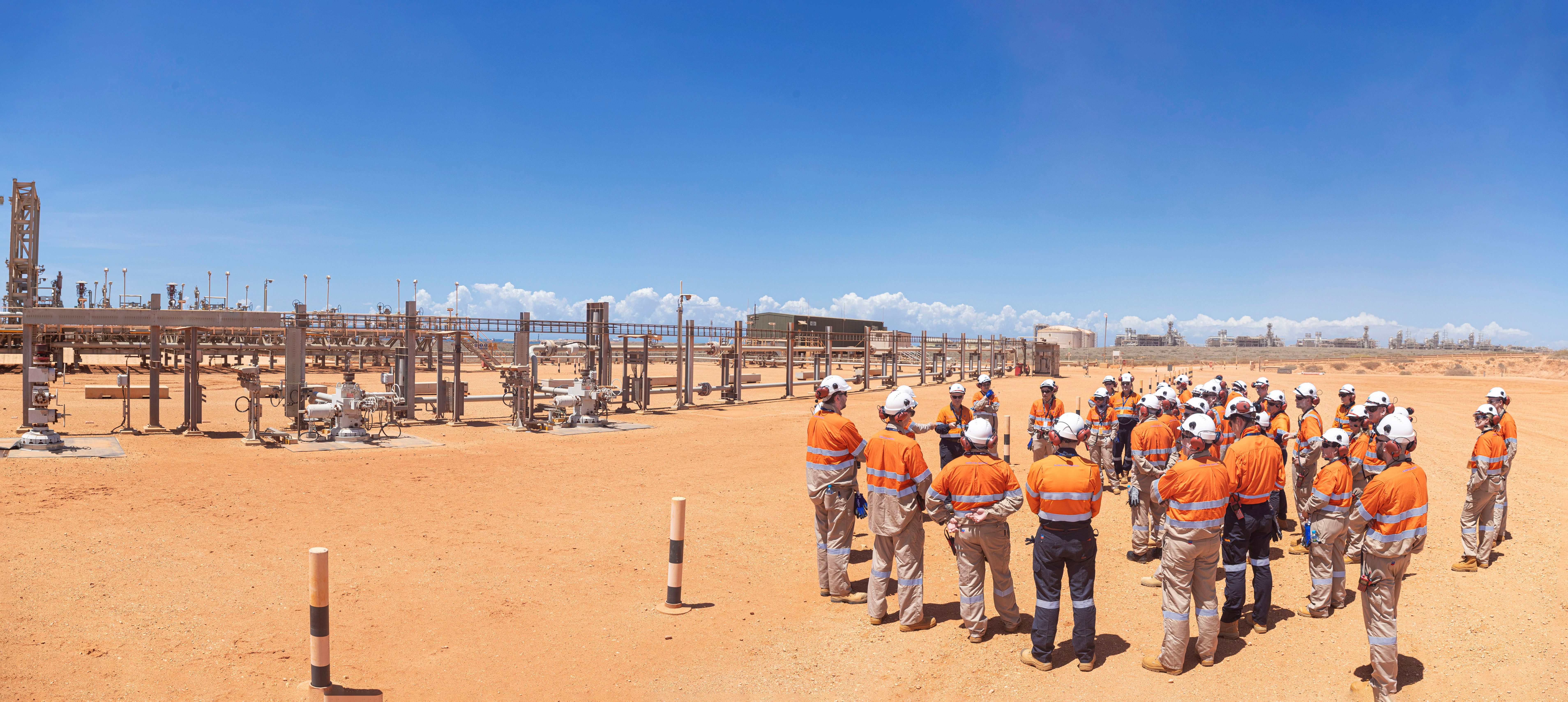

CCS in operation at Chevron Australia's Gorgon natural gas plant, Western Australia. Credit: Global CCS Institute

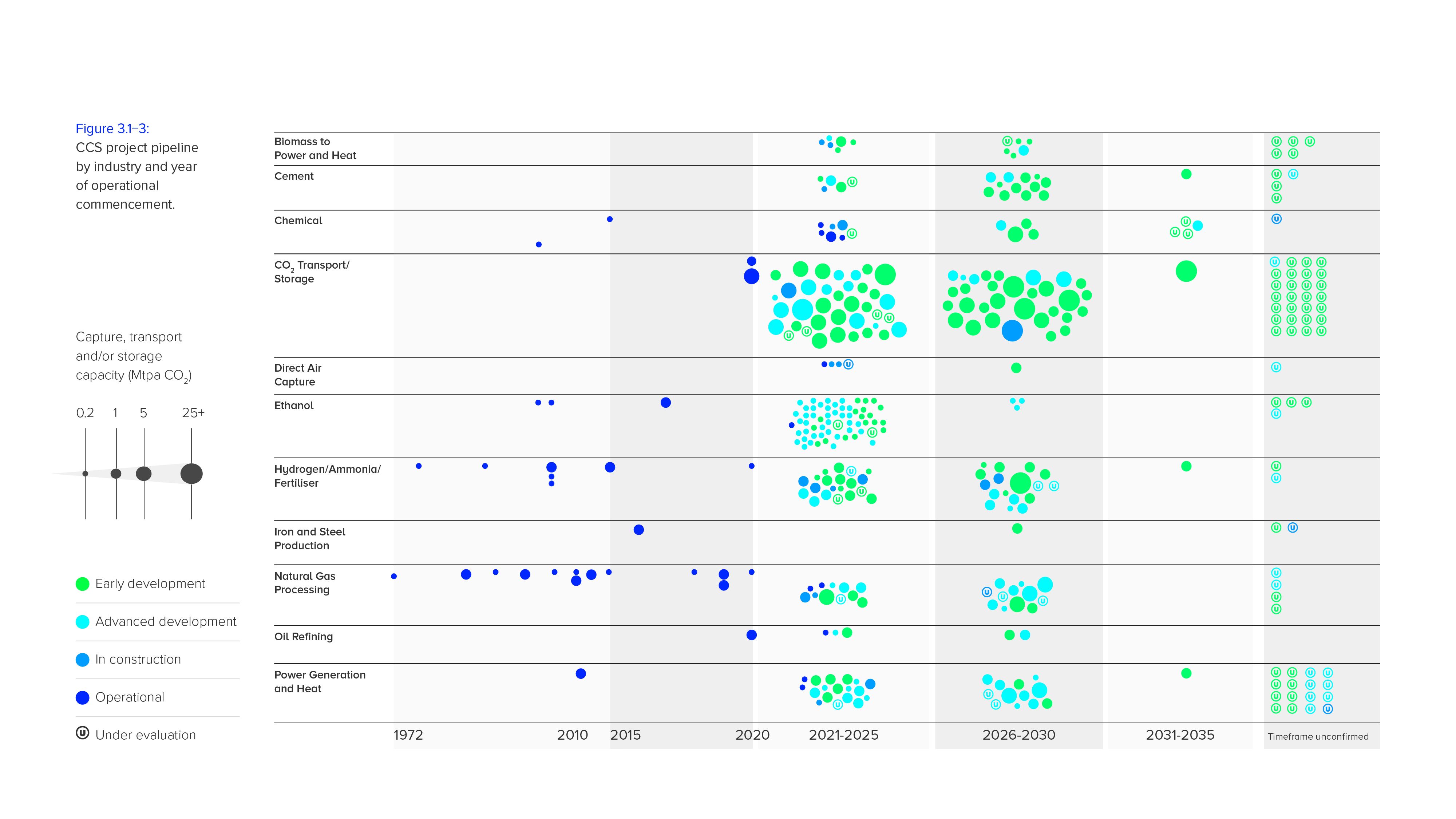

Scale-up of CCS project capacity is being driven mostly by North America, where the United States leads in deployment with 73 new CCS facilities entering the pipeline in 2023. The top applications for carbon capture in the United States are ethanol, ammonia, hydrogen, and fertilizer production, as well as power generation and heat.
U.S. CCS scale-up is supported by policies and clear regulatory frameworks, which have significantly improved the business case. Economic incentives include the enhancement of the 45Q tax credit for stored CO2, now set at US$85 per ton, through the Inflation Reduction Act. Additional federal funding for CCS projects is accessible through initiatives such as the CHIPS & Science Act (2022) and the Bipartisan Infrastructure Law (2021).
The United States’ goal of carbon-free electricity by 2035 has also turned attention to the potential to scale up CCS at fossil-fuel power plants. Projects at various stages of development continue at 23 power/heat facilities, with more than half planning to be operational in the late 2020s.

CCS project pipeline by industry and year of operational commencement. Credit: The Global CCS Institute’s 2023 Global Status of CCS Report.
