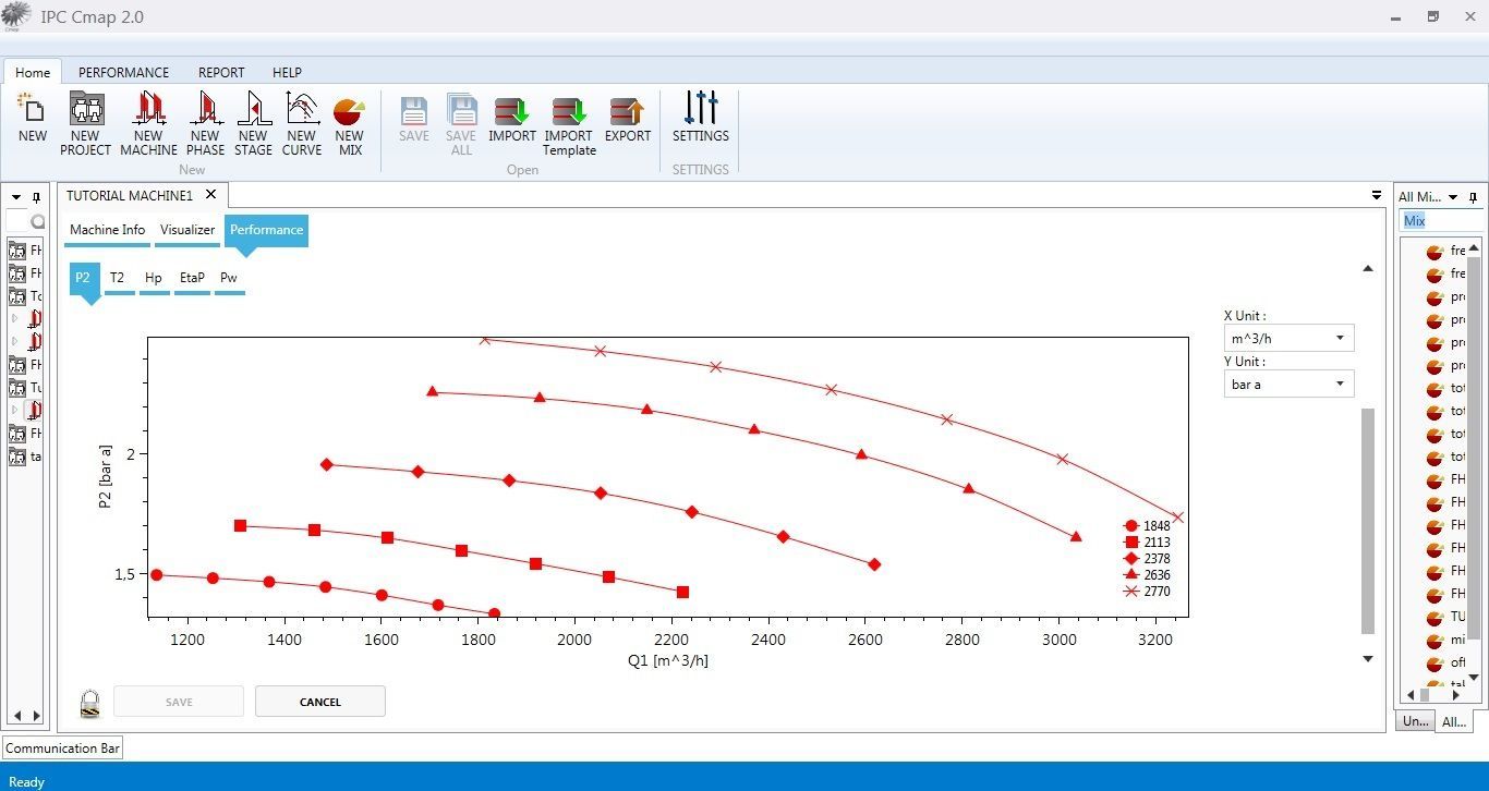

As said the starting point is the availability of an OEM centrifugal compressor performance curve in specification conditions, along with relevant gas mix composition and thermodynamic conditions (pressure and temperature). Having this input data available, the CMap software will perform all complex calculations in fully automated way and will produce the predicted compressor performances for test inlet pressures, inlet temperatures and Freon R134a different from the design / reference ones.
Fig 1: screen shot Cmap[/caption]
CMap allows to perform the compressor performance prediction using different equations of state (EOS) depending on gas mix considered in the calculation. For hydrocarbon gas mixture Lee-Kesler or PREOS can be used. For Freon R134a the MBWR EOSshall be selected to determine the thermodynamic properties of the operating fluid.

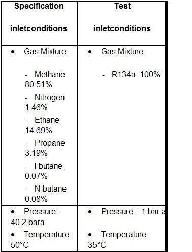

After this first calculation step it will be possible to proceed to the comparison of the predicted tested performances to the actual tested performances. The next table shows the inlet condition of predicted performance and inlet condition of tested performance:
Table 1[/caption]

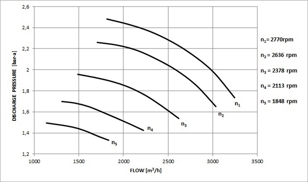

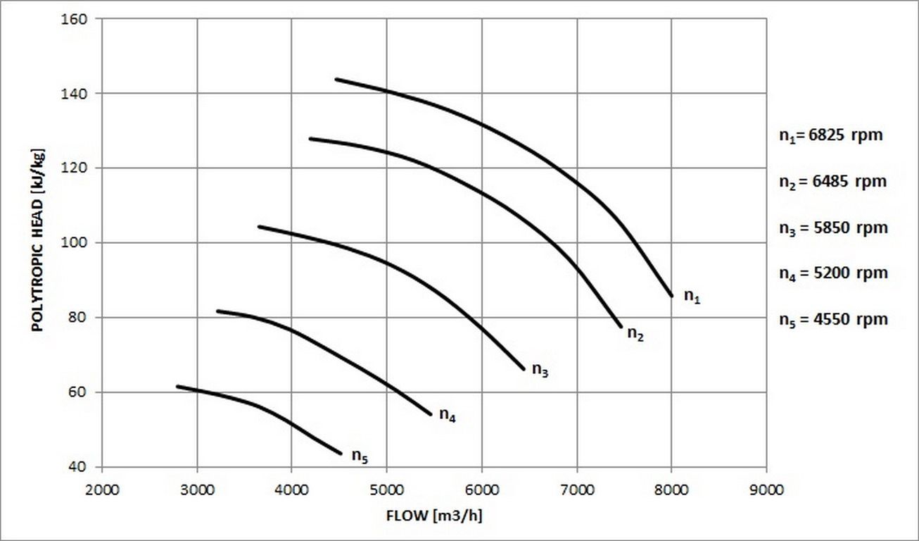

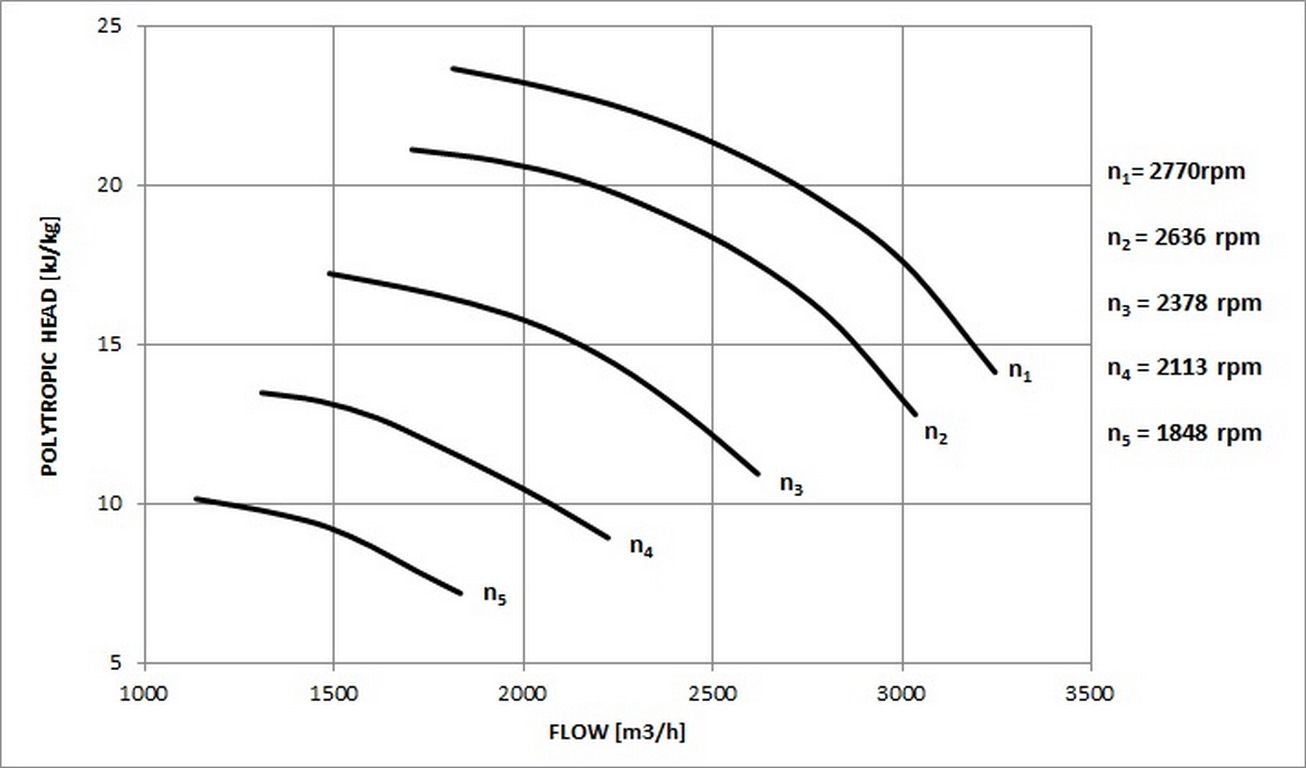

Starting from the centrifugal compressor performance map in specification conditions, the tested performance curves have been calculated.
The following picture shows the predicted tested performances curves obtained.
Fig 2: discharge pressure in Specification condition[/caption]

Fig 4: discharge pressure in test condition (with Freon R134a)[/caption]
Fig 5: polytropic head in test condition(with Freon R134a)[/caption]
