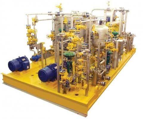

Equipment function test assures proper field operation of auxiliary unit
Having properly specified, designed and manufactured the auxiliary unit, its proper arrangement and operation must be confirmed. This is accomplished during factory testing and inspection.
The objectives of this phase are to confirm the proper arrangement details and functional operation of the equipment.
It is necessary that we require the FAT (factory acceptance test) for the oil console to duplicate field conditions as closely as possible and record response times for transients (main pump trip and two pump operation), to ensure optimum oil system field reliability.
As a minimum, the following items should be included in the FAT:

The equipment must be thoroughly tested prior to field installation. The test should confirm the functional operations of all components as they will operate in the field. In order to ensure a valid factory test, a test agenda should be prepared approximately two months before test date and reviewed by the equipment purchaser.
In addition, a typical auxiliary system test agenda should endeavor to confirm the functional operation of every component in the system. Specific areas of concern are discussed below.

Functional testing
Having confirmed proper test setup, calibration of all instrumentation, proper fluid and test instrumentation, the functional test is now ready to be performed. As a minimum the following tests should be performed on any auxiliary system console:
  • Relief valve test (if supplied)
  • Transfer valve test
  • Auto start test of auxiliary pump with the following conditions:
  • Main pump tripped
  • Two pump operation (main pump in operation, standby pump started)
During all functional testing, any system pulsations or pressure drops above specified values are reason for non-acceptance of test. All components not meeting requirements must be corrected and units must be completely retested.
The value of testing the auxiliary console with the unit should be seriously considered. Since the console and the unit piping from the specific auxiliary system, there is a significant benefit to testing both together. Additional costs of such a test should be evaluated against the potential reduction of reliability and loss of operation time in the field if any malfunctions exist that were not determined by the test of the console alone.
Failure to completely check all oil system component functions during the FAT will result in delayed start-up and possible lower than anticipated unit reliability for the life of the process unit.
