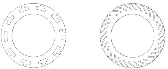

Dry gas seals are face seals that use fine laser or chemical etching to create shallow pumping grooves about 0.0003 inches deep in one of the seal faces. When spinning, these grooves pump gas into the gap from the high-pressure side to increase the pressure of the gas between the faces. These grooves are modified depending on the application for the seal, for instance some grooves may provide for rotation in both directions and another design might be optimized for rotation in one direction (Figure 1).
Figure 1[/caption]

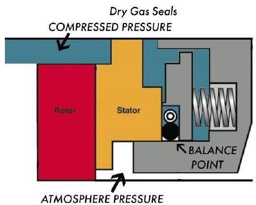

Dry gas seals are also balanced, meaning that the pressure being sealed comes behind the stationary seal face to a balance point (Figure 2). This balance point will expose process pressure to some percentage of the back of the seal depending on the requirements for the application’s closing force. This means the pressure being sealed is squeezing the two seal faces together. This pressure is also trying to get between the two seal faces and push them apart. Obviously if the pressure can push the seal faces wide apart, it would not be a seal. So, seal designers always want a higher closing force to maintain seal functionality, but not so high a force as to create heat or wear on the dynamic surfaces. This closing force is typically a function of the balance point and the springs selected.
Figure 2[/caption]
The genius of using process pressure to balance most of the change in forces is that it is self-regulating. The pumping grooves cover the load capacity of the extra closing force required from the springs.
This is a relatively narrow margin and dependent on conditions like speed and cleanliness, but dry gas seals have virtually replaced all oil seals in new compressor builds.
It is interesting to look to the gas lubrication conditions in DGSs; if there is 2000psi being contained by the seal, then there will be 2000psi of unit loading in the fluid film, as that is the pressure squeezing the faces together. The pumping grooves in the seal faces create enough of a pressure margin to keep a gap between stationary and rotating faces. This gap might be quite thin because the pressure difference from the pumping grooves will not be very high. Shear losses in fluid film lubrication are a cubed function of the gap so very small gaps can generate a lot of shear heat, even in gases. DGS seal faces are often made from very rigid and thermally stable silicon carbide. The idea is to have stiff and thermally stable surfaces to keep the faces flat even under the high pressures or thermal gradients they see from shear in operation. If the gas gap is only 0.00015 inches, the relative flatness of the surfaces needs to start off and stay, less than the gas gap. Still with these caveats, amazingly 2000psi is higher unit loading then can be achieved with hydrodynamic oil bearings! Where DGS have been applied, they have eliminated issues with process contaminated seal oil and improved efficiency with orders of magnitude less friction. DGSs are a dramatic improvement over oil seals and an impressive example of gas bearing lubrication.

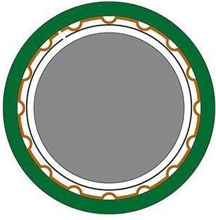

There are many types of foil bearings, most common are the Bump and Overleaf types. The Bump Foil Bearing (BFB) consists basically of a thin flat piece of spring steel that is stamped to have waves that constitute the bumps, it is rolled and inserted into a precision bore. A thin top foil, often with a low friction coating is inserted into the ID and is supported by the bumps (Figure 3).
Figure 3[/caption]
Generally, only a few thousandths of an inch of radial clearance is designed between the top foil face and the OD of the rotor, since clearances can be a challenge working with stampings and foils, the idea is that the bumps are compliant and as the load goes up, more bumps come in to play, distributing the load across a broad area. The rotor could still whirl or whip inside of the design clearance, so it is not unusual to see BFBs shimmed between the precision bore and the bump strip to reduce the clearance in three or four spots.

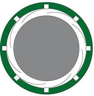

The Overleafis an alternative foil design, rather than using a continuous top foil, separate but stiffer leaves overlap but have longer bending moments, this provides relatively low stiffness over a larger range (Figure 4). This helps to provide the classic wedge-shaped gas gap and reduce whirl and whip instabilities, but the bending of the leaves produces even less damping than the friction losses in the BFB. It is though, relatively easy to get some preload, that is a bearing inner ID smaller than the shaft OD without shim. It is also common to see the Overleaf design in thrust bearing applications.
Figure 4[/caption]

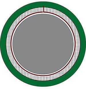

A third type of foil bearing, Metal Meshfoil bearings have been attracting a lot of interest and research in recent years (Figure 5). The idea is like the BFB in that there is a continuous top foil, but it is supported by a metal wire mesh, sort of like a sponge rather than bumps. The mesh may be of stainless steel, aluminum or copper. The friction losses between the wires in the mesh as they “spring” is said to result in a damping mechanism that is insensitive even to the high heat levels in gas turbines.
Figure 5[/caption]

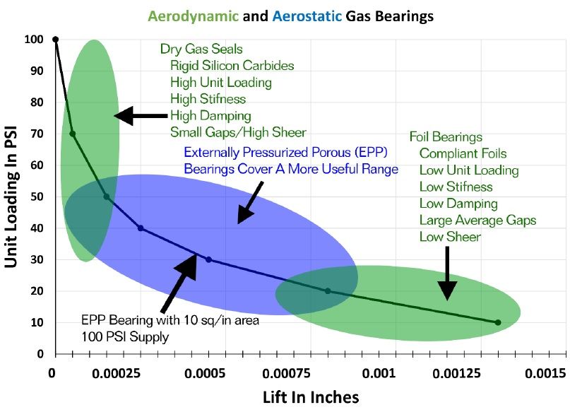

The accompanying charthelps to conceptualize gas bearing lubrication technology in turbo equipment (Chart 1). It is a lift vs load chart for the Externally Pressurized Porous (EPP) gas bearing described above that has 10sq.in. of bearing face, 100psi is fed to the bearing as the load on the bearing is increased. Resulting air gaps are shown on the bottom axis. The slope of the curve around any load point is representative of the film stiffness at that load. This curve is similar to curves seen for DGS or eccentricity plots used in rotor dynamics. The typical operating regions of DGS and foil bearings are superimposed as is the operating area for EPP Bearings.
Chart 1[/caption]
It can be seen that the EPP Bearings operate with a larger gap than dry gas seals, reducing heating and contact issues but still having good load capacity, stiffness, damping and speed capabilities. Possibly the biggest advantage is that external pressurization gives an equipment operator a new knob to turn, being able to adjust the bearing or seal from outside the machine. If the seal or bearing is running hot, turning up the source pressure will increase the gap proportionally with the increasing pressure, but there is leverage, as shear in the gap will fall on a cubed function of the increasing gap.
This adjustability is also an advantage regarding rotor dynamic issues. The destabilizing effects of cross-coupled stiffness are caused by the parasitic shear losses in the fluid film as the rotor gets traction to climb up the side of the journal.Don Bently clearly pointed out that when the viscosity of the fluid film is reduced by two orders of magnitude, cross-coupled instabilities are eliminated as the rotor gets no traction at the same relative surface speeds. This is important for increasing the machines efficiency but also allows for dramatically increasing surface speeds. At some point the increasing speed will start to cause significant shear again but remember that the bearing properties of externally pressurized bearings may be modified while in operation by adjusting the pressure supply regulator as noted above.
It should be noted that it is not desirable to increase the input pressure more than necessary, a larger gap than needed reduces stiffness and damping, just as seen in rotor eccentricity plots. So consistent with eccentricity plots, although it may be counterintuitive, turning the air pressure supply down will increase the stiffness and damping as the gap is reduced. Dr. San Andres of the Texas A&M Turbo Lab has been studying EPP gas bearings and noted “Gas bearings with external pressure permit operation with minute clearances and offer high stiffness for accurate positioning while operating with little shear drag and provide enhanced stability due to the absence of cross-coupled stiffnesses induced by hydrodynamic effects.”3
It is commonly thought air or gas bearings have little damping. This because most applications have used gas films of .001 inches or more. At this point on the curve, there is near zero stiffness. At zero stiffness there can be no damping, it is like hanging the rotor on surgical tubing to ring it and find its undamped natural frequency. As supply pressure is reduced, stiffness increases, providing resistance to motion and so providing damping. As some point the stiffness can become too high, if there is zero motion there can also be no damping. The ability to adjust bearing parameters in externally pressurized bearings with something as simple as a pressure regulator is a big advantage over oil or foil dynamic bearings that are not adjustable and alsomagnetic bearings there are more complicated to adjust.
There is still another important advantage to the damping associated with gas bearings. As noted above, stiffness can be too high. A squeeze film oil damper may provide high damping at 3600rpm but at 10,000rpm provide no damping as it locks up, becoming infinitely stiff relative to the higher frequency vibrations. Because of the low viscosity of air and gasses, gas bearings are appropriate for damping high frequency vibrations. This is consistent with the higher speed capabilities of gas bearingsand the trend toward smaller higher speed turbo equipment.
