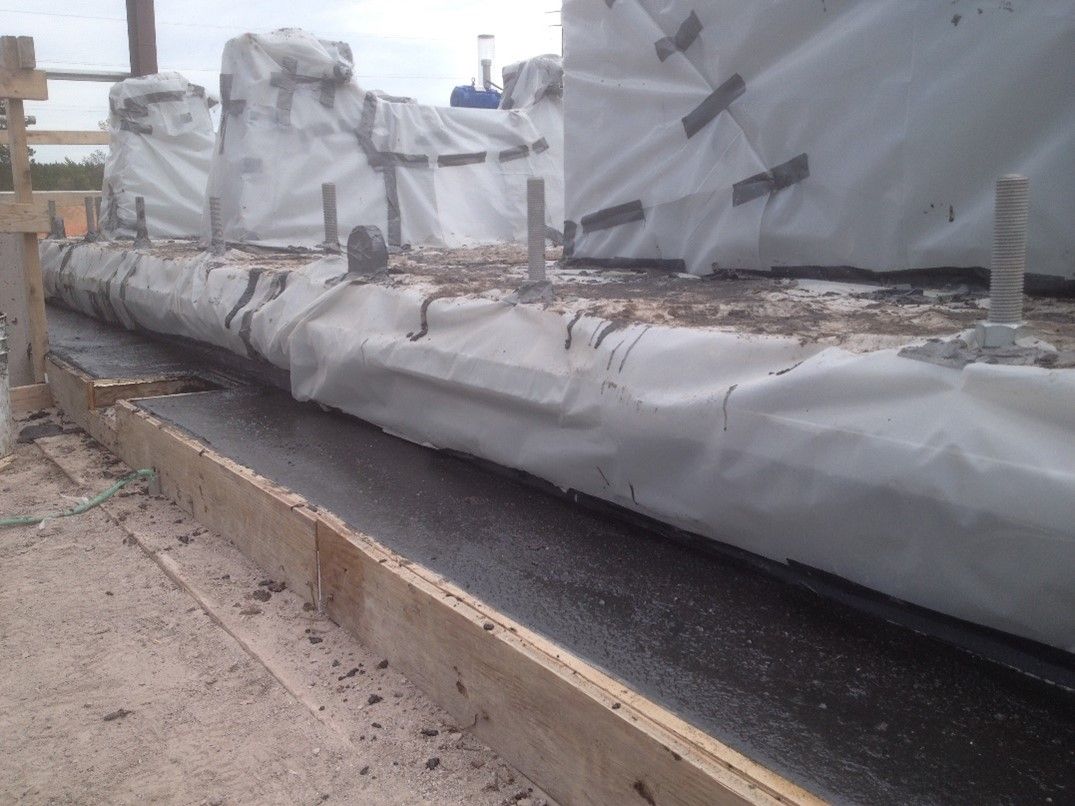

Installing grouts is straightforward. Concrete foundations or bases should be 28 days old so they have achieved strength and drying shrinkage has taken place. Surface preparation should conform to a surface profile of 5-7 according to ICRI (International Concrete Repair Institute) Guideline 310.2, exposing the coarse aggregate of the concrete. Clean any residue with a vacuum, pressure wash, vacuum the water, and let it dry completely.
Forms must be tight, and the metal surface being attached should receive a suitable primer. Once this is complete, mix the epoxy. If there is a significant amount of epoxy, care should be taken to have a mixing process in place so there is a constant stream of material available until the void is filled. Place the epoxy by pouring it through the openings in the base. This is an abbreviated set of instructions to understand the process. Confirm the process with your specific grout manufacturer.
