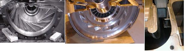

Channel diffuser, low solidity vaned diffuser and rib diffuser[/caption]

Some process compressor OEMs attempted to apply channel diffusers. The name comes from the fact that two adjacent diffuser vanes form a passage or channel. These diffusers do provide superior static pressure recovery, CP, with peak CP levels reaching 75 percent - 80 percent. However, channel diffusers also cause a substantial reduction in flow range, making them undesirable for compressors that must operate over a range of flow conditions. As a result, channel diffusers are rare in process compressors but somewhat popular in air machines, gas turbine gas generator compressors, or turbochargers, which do not require wide flow range.
Vaneless diffusers were the most widely-used style in industrial centrifugals until the late 1980s when some OEMs began applying a style known as the low solidity vaned diffuser. Unlike the channel diffuser, the vanes in a low solidity vaned diffuser (LSD) do not form a channel and also have no true geometric throat.
The most important benefit is that LSDs provide nearly the same operating range as a vaneless diffuser yet provide greater pressure recovery and, therefore, higher stage efficiency. The introduction of the LSD provided a step change in stage efficiency without significantly reducing the flow range. However, the efficiency enhancement seemed to be limited to medium- to low-flow coefficient stages; i.e., f < 0.080 and smaller; with the greatest benefit being in flow coefficients, f, less or equal 0.030.
More recently, select OEMs have re-introduced the rib diffuser, a special class of LSD with vanes that do not cross the entire flow passage. These diffusers were first suggested in the mid-to-late 1970s but did not gain broad acceptance until much later. Again, this style of diffuser provides an efficiency boost in some flow coefficient ranges but is ineffective in others. Those seeking more details on this style are directed to the work of Sorokes and Kopko.
