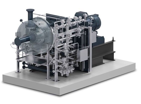

A single-stage integrally geared turbo compressor was deployed for the pilot vessel. It supports the H2 loading and offloading process.

University labs and suppliers worked closely with Atlas Copco Gas and Process as part of the development of a liquid hydrogen solution: an open-milled, light-alloy aluminum impeller with a cast S-steel volute vertically split casing and machine plate diffuser. Around the casing was a cutting-edge vacuum insulation solution that ensured oxygen could not liquify from ambient air.

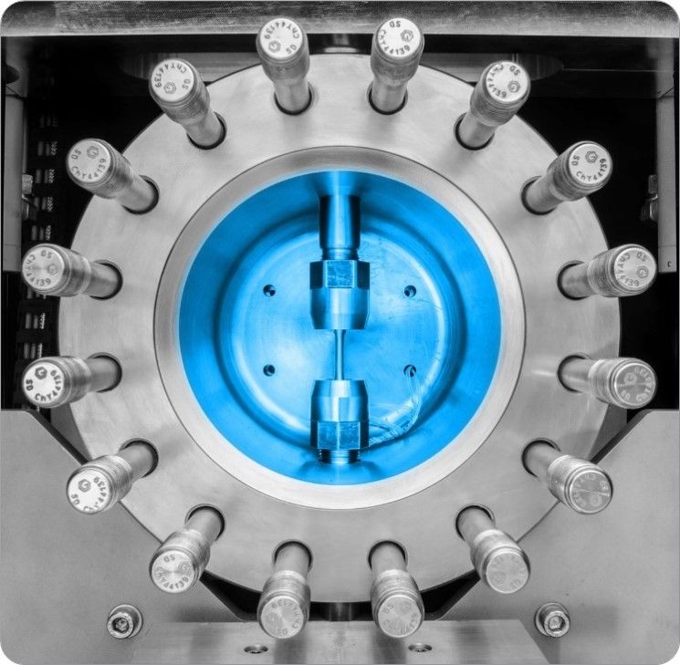

Materials qualification procedures entailed testing materials down to liquid helium, -269° C: Impact and tensile tests were carried out for materials that contact cold hydrogen. The seal gas system, which also acts as a heating medium, was perhaps the biggest challenge. The compressor required a constant supply of warm hydrogen to prevent condensation and solidification of nitrogen and/or oxygen, which could damage the shaft. As the shaft temperature is so low, primary seal gas consumption is high. Additional heat flow into the shaft is generated by warm oil in the bearing area.

Materials testing for the compressor was based on new research and development, supported by work from university labs.
