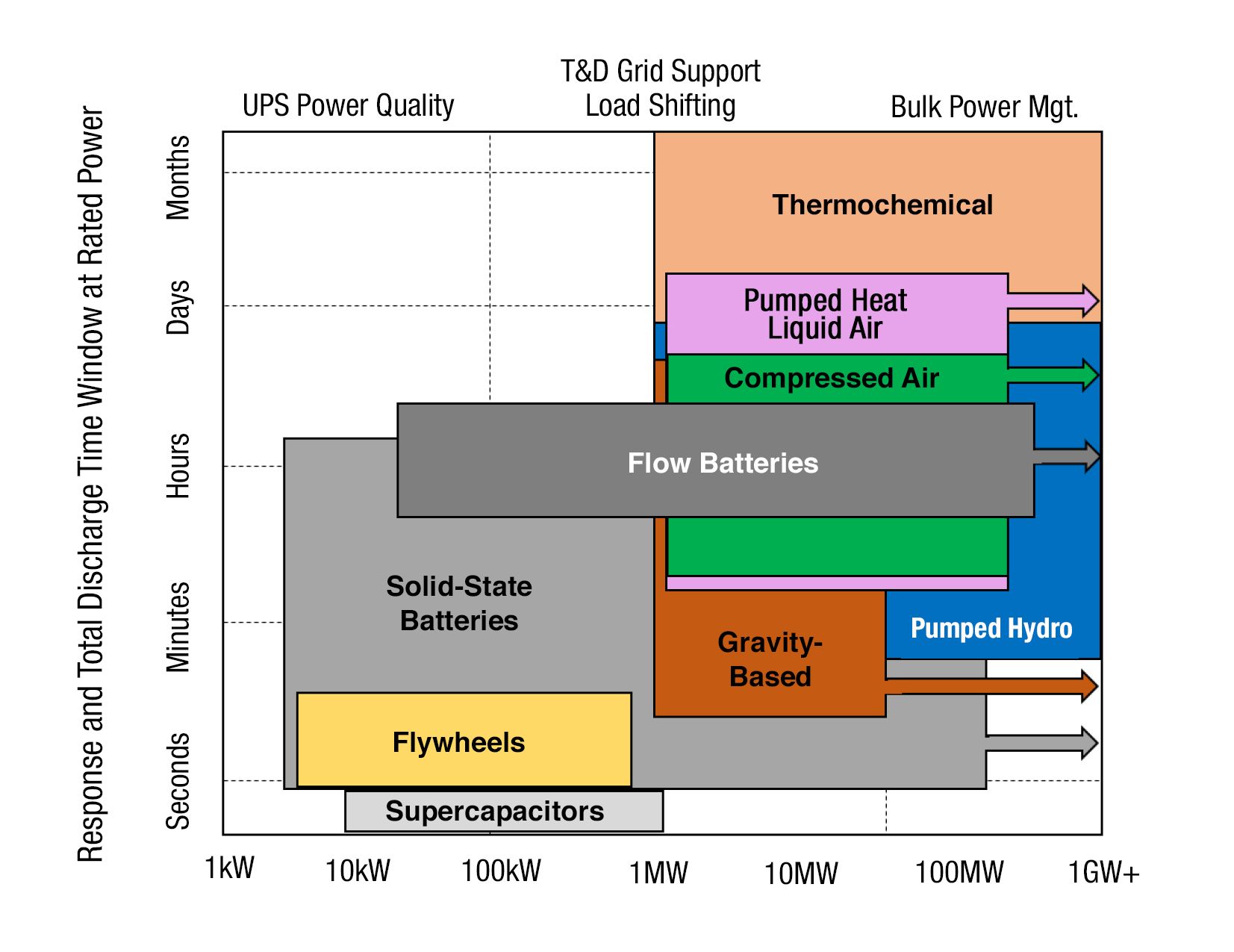

Hydrogen is used in a power-to-gas (P2G) approach as energy storage for excess renewable power that can be stored at high pressures and transported via pressurized pipelines, typically up to 1,440 psi. However, compressing hydro-gen is power-intensive due to its energy density being very low on a volumetric basis. Compared to natural gas pipelines, for equivalent energy volumes, hydrogen compression will likely require 5 - 6 times the power (FIGURE 1)1. This makes efficiency in design and the overall footprint requirement key aspects when evaluating various compressor technologies.
FIGURE 1. Comparison of Energy-Storage Forms – Discharge Time vs. Rated Power

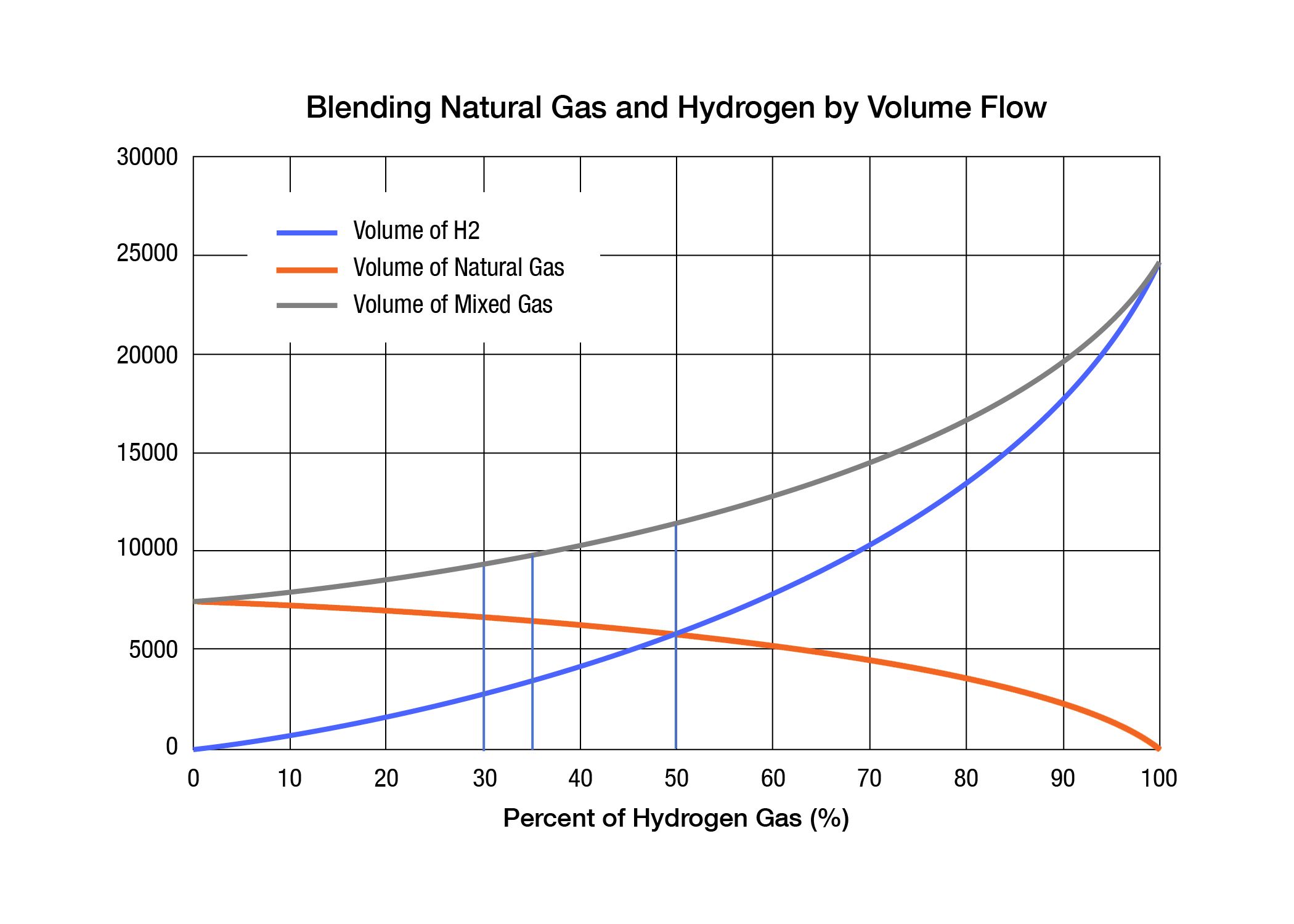

Due to hydrogen’s low energy volume density compared to pipeline-quality natural gas volume density, in blending hydrogen with natural gas, appreciable concentrations of hydrogen will be needed to significantly decrease carbon emissions. The Btu/min flow to the turbine must remain constant for the 50 MW combustion gas turbine system shown in FIGURE 2 for a blended fuel stream, which means that the natural gas flow falls off non-linearly with increasing hydrogen content. Operators will need to blend more than 50% hydrogen to start making an appreciable difference in carbon emissions, and many gas turbine manufacturers are already investigating means of operating at 100% hydrogen fuel.
FIGURE 2. Calculated Equivalent Fuel Volumes for LM2500 Combustion Gas Turbine Producing 50 MW at ISO Conditions

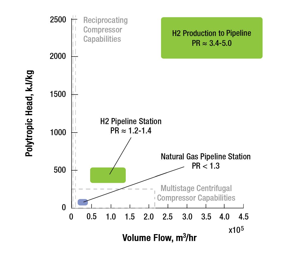

The challenge with hydrogen compression is in the large flow rates and the variety of pressure ratios required for the decarbonized energy market compared to compressors used in refinery applications. The higher compression ratios required for the transportation/power sector will require design adaptations for both reciprocating and centrifugal compressors, including enhanced sealing methods, alternative valve selections, and additional staging.
FIGURE 3 displays some of these requirements relative to the head/flow capabilities of existing reciprocating and barrel-style multistage centrifugal compressors for a range of hydrogen flow conditions corresponding to transported fuel energy content from 6-25 GW (500-2,150 MMSCFD natural gas), which correspond to a range of pipeline sizes analyzed in Allison, et al., 2021.3
FIGURE 3. Comparison of Hydrogen Compressor Requirements vs. Capabilities for Pipelines Transporting 6-25 GW (500-2150 MMSCFD)
The two lower-left solid rectangles show a comparison of natural gas versus hydrogen compressors for transport at pipeline stations, where compression requirements increase for hydrogen due to the lower volumetric energy density of hydrogen and the thermodynamic properties of hydrogen that require more power to achieve the same pressure ratio when compared with natural gas. The upper-right solid rectangle illustrates compression requirements for boosting hydrogen from its production pressures of 20 - 25 bar to pipeline pressures of 85 - 100 bar. The dashed rectangles show the capabilities of existing technologies for hydrogen compressors. In general, reciprocating compressors may struggle with meeting flow requirements for hydrogen compression, whereas centrifugal compressors will struggle to meet the head requirement for hydrogen compression in a single unit.

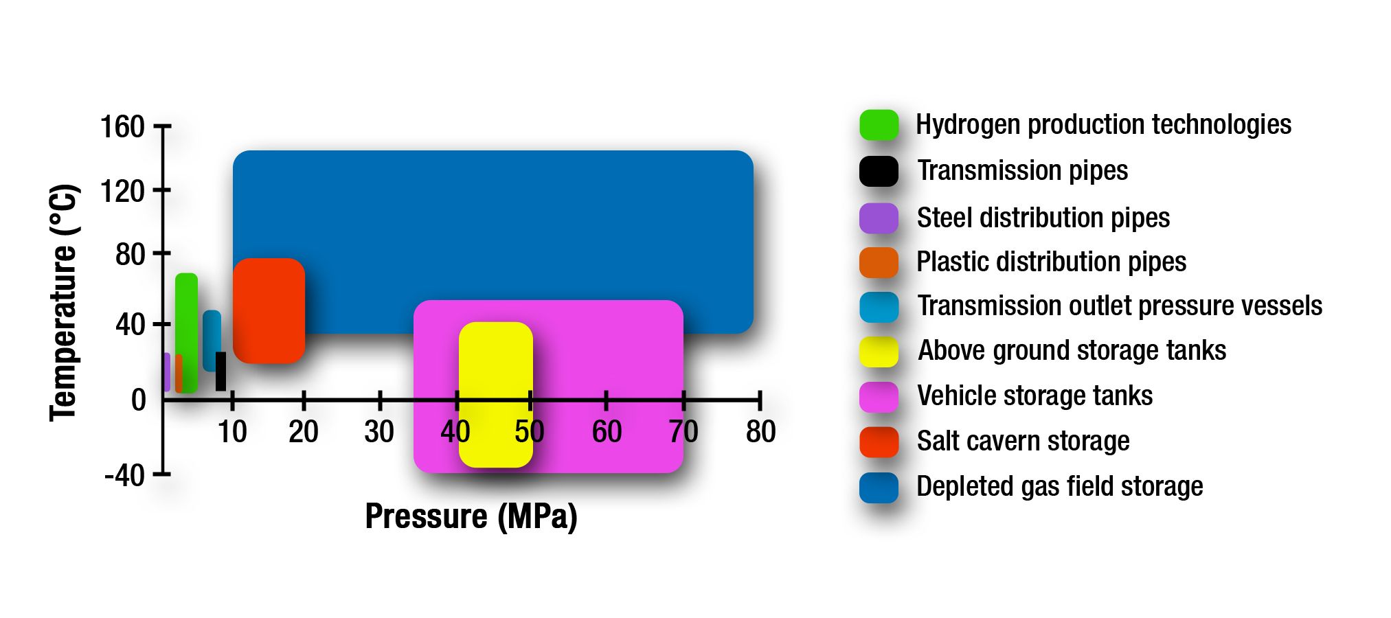

In addition, to harness excess renewable power in P2G applications, hydrogen compressors for storage will need to likely deliver at 3,000 psi and above (FIGURE 4)4 for injection at the top end of the reservoir.
Initial boosters to take hydrogen from production pressure to pipeline pressures (atmospheric to 100 psi) will require hydrogen compressors capable of a high number of multiple stages due to significant head requirements. Hydrogen compressors will need to move to designs at higher rated motor and engine drivers, likely 10 MW and above, and compression design variability for a range of pressure ratios. The compounded effect of low energy density by volume and high head due to its high specific heat makes hydrogen compression challenging and power-intensive.
FIGURE 4. Hydrogen Storage Pressures and Temperatures

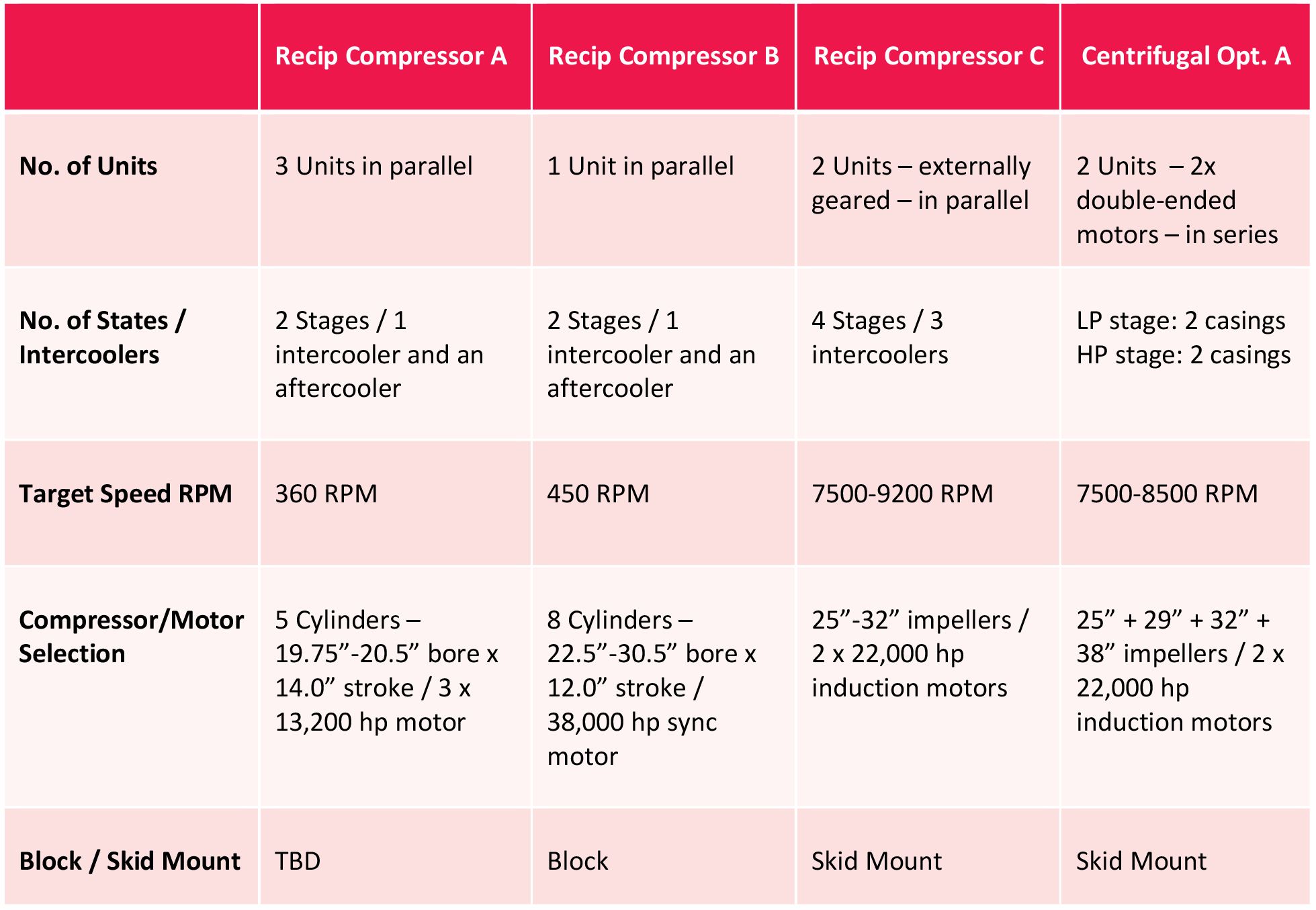

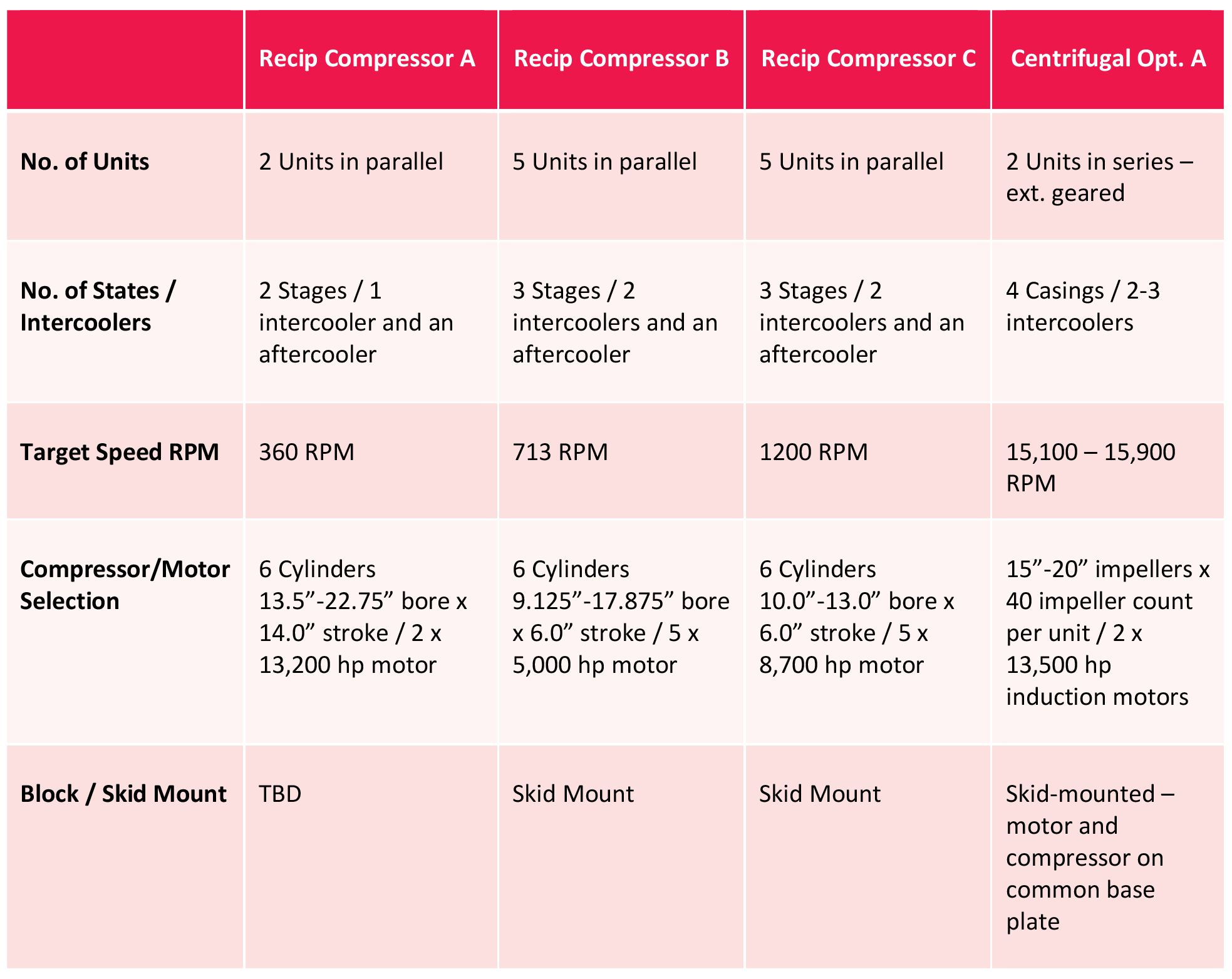

The following tables (TABLES 1, 2, and 3) compare the advantages and disadvantages of the various compression options for hydrogen.
TABLE 1: Comparison of “Mainline Flow” Compressor Options for Hydrogen
Ps = 169 psia, Pd = 1,440 psia, Q = 150 MMSCFD, Ts = 160°F

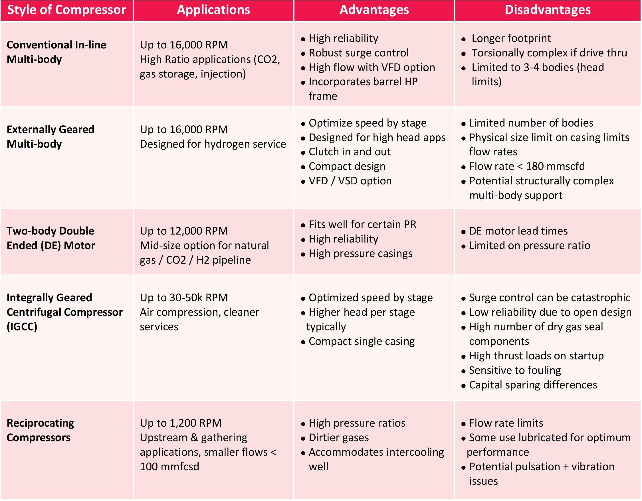

TABLE 3. Comparison of “Mainline Flow” Compressor Options for Hydrogen
The various hydrogen technologies that are currently available each have distinct applications where the compressor choice may be more apparent. However, in many applications, an overlap of competing technologies can be expected. It is in the best interest of operators to compare these technologies for each application space and to evaluate details of the compressor offerings such as overall physical size, accessibility for operations, capex/opex cost, manufacturer experience, and durability of each technology.
