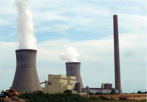

Closed-cycle Cooling – One final option, when appropriate, is to switch from an open-cycle to a closed-cycle cooling system with the use of cooling towers. If not possible for the entire facility, even switching parts of the plant to closed-loop cooling can reduce the amount of cooling water needed. However, the high costs and potential for other environmental impacts of this technology need careful consideration.
