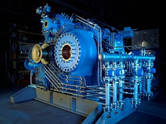

(Numerous six- stage integrally-geared turbocompressors preceded the 8-stage machines presently used for high-pressure CO2 service. Source: MAN Turbo, Oberhausen, Germany; also Ref.1)
Other mechanical features of these successful designs included “Flexure Pad” bearings, hydraulically fitted coupling hubs, and diaphragm spacer couplings at the driver connection. The motors are of synchronous across-the-line starting design with liquid cooling. An OEM-designed control system manages ramping up to speed and continuously monitors machine condition. The control system is integrated into the plant’s digital control system (DCS), along with shaft vibration, thrust position, and bearing temperature monitoring --- all arranged for automated alarm and shutdown.
