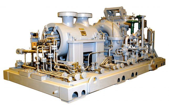

Figure 1: Elliott hydrogen hydrocracker compressor used in refinery processes.
This unit processes a low mole weight gas (4.0 MOL) that is approximately 91.5% hydrogen. It has five impeller stages, an inlet pressure of 2,335 psia, maximum continuous operating speed of 12,027 rpm, and can process 1,692 ICFM through its 10-inch inlet nozzle.[/caption]
Elliott’s work in hydrogen compression can be seen in hydrocracker machines found in many refinery and petrochemical processes (Figure 1). The company continues to advance its hydrogen compression capabilities with developments in areas such as hydrogen recycle, pure hydrogen, net gas hydrogen, and hydrotreater feed. High speed and long bearing span are best addressed with advanced rotor dynamic analysis and robust bearing designs. The number of stages per compressor should be limited to keep the bearing span and vibrations within acceptable levels. The risk of hydrogen embrittlement should be managed by restricting the yield strength of the materials used and adding stainless steel cladding or coatings.

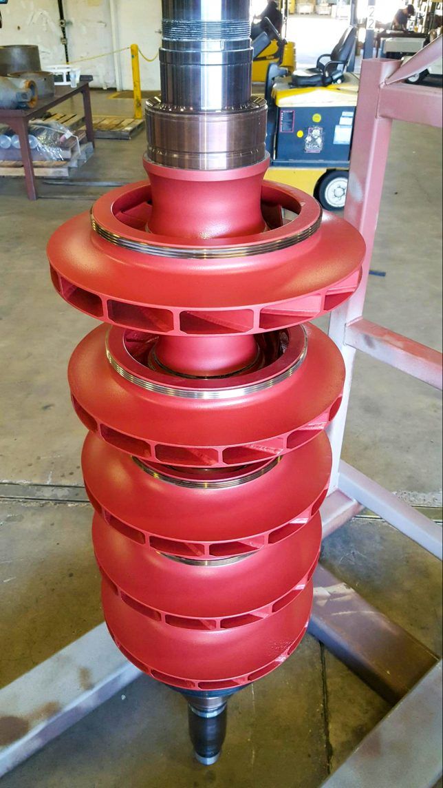

Figure 2: A specialty hydrogen recycle coating developed by Elliott was applied to a 5-stage compressor rotor in hydrogen service. Its anti-fouling properties prevent buildup of material in the gas path, provide corrosion resistance against ammonium chloride, and increase wear and durability resistance to solid particle erosion. It is good for continuous operation up to 500°F (260°C).[/caption]

Hydrogen recycle machines in refineries have specific corrosion and fouling concerns due to ammonium chloride, which can form during the process. Ammonium chloride is highly corrosive, and traditional compressor coatings are not effective in minimizing corrosion and fouling due to ammonium chloride. A specialty coating is available to deal with such issues (Figure 2). It is typically used in refinery processes, particularly if the compressor runs on nitrogen for startup or catalyst regeneration. Pure hydrogen compressors would not require this type of coating.

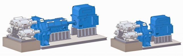

Figure 3: The Flex-Op arrangement, developed by Elliott in collaboration with Voith Turbo, is comprised of three to four individual centrifugal compressors arranged around a single multi-pinion gearbox. The stages are split up into separate bodies to manage the bearing span.[/caption]

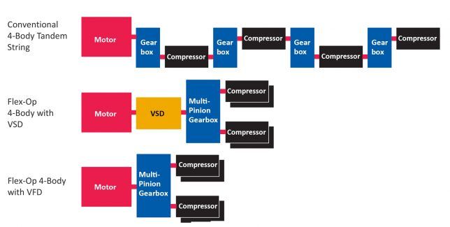

To improve the head, flow, reliability, and operational flexibility capabilities of hydrogen compressors, the Flex-Op compression arrangement has been developed (Figure 4). It is comprised of four compressors on a single gearbox. In addition to hydrogen compression, it is suitable for energy storage, processes, refining, and chemical compression. Originally designed for high-pressure ratio and high-flow compression, it has enough flexibility to allow individual compressors to either run in series or in parallel (or both) (Figure 3).
Hydrogen compression requires a large number of compression stages to achieve a reasonable head for a very light gas. With the Flex-Op arrangement of three to four casings, up to forty impeller stages can fit into a footprint that traditionally only fits up to ten. This shrinks the linear footprint of the compressor section from upwards of forty feet to roughly ten feet and offers up to four times the compression capability within the approximate linear footprint of one compressor (Figure 4).
Figure 4: Conventional compressor tandem versus Flex-Op arrangements.[/caption]
This design is operationally flexible. It can run up to four compressor casings in series or in parallel, with multiple extractions and side streams. Since each rotor is connected to its own pinion via a flexible shaft coupled to the central gear, the rotor speeds can be individually optimized for highest aerodynamic efficiency. A barrel casing coupled with a single multi-pinion gearbox allows the whole assembly to be powered by a motor with a Variable Frequency Drive (VFD) or a motor in conjunction with a Variable Speed Drive (VSD) (Figure 5).
Figure 5: Flex-Op couples up to four Elliott barrel casings with Voith’s single multi-pinion gearbox, powered by a motor with a VFD, or by a motor in conjunction with a VSD for speed control.[/caption]
The gearbox design enables each compressor to operate at a different speed. If clutch or torque converter couplings are implemented at the compressor shaft ends, engagement/disengagement of individual compressors is possible. The arrangement of the casings allows the compressors to operate in parallel for double the throughput, or in series with intercooling between bodies for maximum pressure ratios. The series option is important for higher pressure ratios with low mole weight gas.
