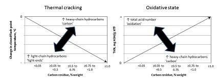

Monitoring heavy-chain hydrocarbons, light-chain hydrocarbons and TAN is therefore critical to all plants using HTFs. This can be achieved by trending values against time. However, additional plots of carbon against closed flash point temperature (thermal cracking) and carbon versus TAN (oxidation) may be helpful in defining the underlying changes and this may be helpful in targeting specific changes with suitable interventions. This is demonstrated in Figure 1 where plots for thermal cracking (left panel) and oxidation (right panel) are illustrated.
This schematic shows that carbon is common to both processes. The x-axis is plotted for graduations of carbon and represents the following condition ratings: <0.05, satisfactory; ≥0.05 to <0.05, caution; ≥0.5 to <0.75, action; and, ≥1.0 percentage weight, serious. Closed flash point temperature and TAN also have ratings based on their condition, but these are not presented. Figure 1, left panel shows that as carbon increases, closed flash point temperature decreases. For schematic purposes this is shown to be linear. Deviations from the forty-five degree line represent the build-up of excessive carbon (i.e., top right hand corner) or excessive light-chains or ‘light-ends’ (bottom left hand corner).
The same plot is presented in the right hand panel of Figure 1. Again, deviations from the forty-five degree line reflect excessive changes in carbon (bottom right hand panel) and oxidation (top left hand panel). These changes need to be managed and interventions available are discussed in further detail below.

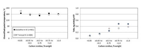

Real world data on the state of thermal cracking and oxidative state of a mineral-based heat transfer fluid
Figure 2 presents real world data for two mineral-based HTFs using thermal cracking and oxidation plots. These plots were obtained by searching test results for Globaltherm M (n=981) and BP Transcal N (n=686). Data was then organized by carbon content and the mean values for closed flash temperature and TAN are plotted in Figure 2. Real word data shows that in both cases the closed flash point was stable (~160 degrees Celsius) whilst carbon increased. In the case of oxidation, there were concurrent increases in carbon and TAN. This indicates that oxidation is the key issue affecting the HTFs in Figure 2. Of course, in real life these plots can be used to look at individual test results or pooled data, as presented in this article.
Figure 1, right panel, shows a linear relationship between carbon and TAN. This further highlights the value of plotting data for each test result as this enables gradual changes to be detected and a plan developed to ensure that action is taken when required. Indeed, the client does not want serious levels to be reached as this means a complete replacement of the HTF.

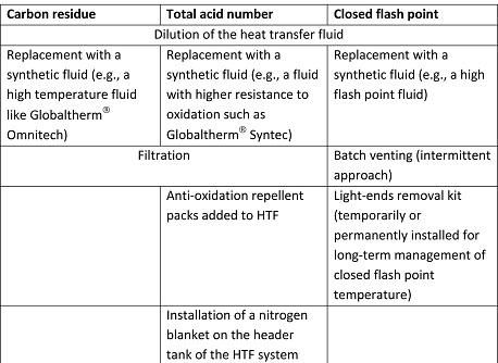

Targeted interventions to address unwanted changes in heavy and light-chain hydrocarbons, and oxidative state
Using the example in Figure 2, the client needs to select a cost-effective intervention to manage carbon and TAN. Interventions that are commonly used include the dilution of a HTF or the complete replacement of the HTF. In reality the latter option should be avoided as this can be an expensive option and normally a last resort. Another option is to use a HTF that can be used at higher operating temperatures and designed to be more resistant to thermal degradation. The same approach can be used for oxidation where the use of a synthetic HTF, such as Globaltherm Syntec, is more resistant to oxidation. Other options in the management of TAN are the addition of anti-oxidant packs / repellents to the HTF system to reduce the oxidation of the HTF or ensuring that there is a nitrogen blanket in the header tank to stop the HTF coming into contact with air.
Filtration is an option for the management of carbon residue and TAN and aimed at removing carbon particles from the HTF whilst in circulation. Filters have variable pore sizes and can be combined with ISO cleanliness tests to monitor wear and contamination particles in the HTF.
Lastly, the management of closed flash point temperature can be achieved through the use of intermittent techniques such as batch venting or permanently installed structures such as a light-ends removal kit. The latter has been shown to stabilize closed flash point temperature for many years.
