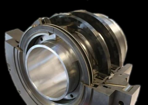

Separation systems
Regardless of the type of seal configuration (double or tandem), the function of the separation system is to prevent process gas from entering the bearing housing in the event of a seal failure, and oil from entering the seal cartridge.
Entrance of process gas into the bearing housing exposes the plant to catastrophic consequences and extended downtime.
There are several types of separation seals. The choice depends on the availability of the separation gas (usually nitrogen). The alternatives, arranged in the order of the highest usage of separation gas are:
  • Labyrinth seals
  • Abradable labyrinth seals
  • Non-contact carbon seals
  • Segmented carbon contact seals
The best practice is to use labyrinth or abradable labyrinth seals if sufficient nitrogen is available.
