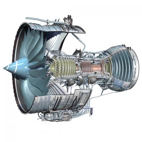

The Trent 1000 engine drives a 11 to 1 bypass ratio large 112 inch diameter carbon fiber composite bladed fan
The 12,700 pound weight Trent 1000 engine drives a 11 to 1 bypass ratio large 112 inch diameter carbon fiber composite bladed fan. A single stage HP turbine drives a 6-stage HP compressor and a single stage LP turbine drives an 8-stage LP compressor. Counter rotation is used to capture some of the swirl velocity between stages and thus incrementally improve expansion efficiency. A 6-stage low-speed power turbine matching the fan RPM drives the fan and thus the first stage of compression. Altogether, there are 15 compressor stages to yield a PR of 52. This PR is the highest known for any fan engine as of today. There are a total of 8 tubing stages. The diameter of the power turbine is quite large because of the low RPM of the fan. The Trent 1000 has a new tiled annular combustor to conserve cooling air for NOx control.
The GEnx fan engine is an advanced version of the existing dual rotor GE 90 engine. It weighs 12,800 pounds. It is similar to the GE 90 in most respects but has a number of refinements and a larger bypass ratio of 9 to 1. The fan blades are made of carbon fiber and the fan diameter is 111 inches.
A two-stage HP turbine drives a 10-stage HP compressor and a one-stage LP turbine drives a 4-stage LP compressor. A 7-stage power turbine drives a carbon fiber bladed fan. There are 15 stages of compression counting the fan to produce a pressure ratio of 43. There are 9 total turbine stages. The diameter of the power turbine is large like that of the Trent 1000 because of the low speed of the fan. The GEnx also has counter rotation of the turbine stages to increase expansion efficiency.
