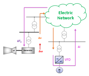

Experience indicates that large power-electronic systems can pose a risk of shaft-line torsional vibrations. As schematically shown in Figure 1, VFDs can electromechanically interact with torsional modes of turbine-generators connected to the same grid leading to torsional instability. This instability can produce network blackout and/or damage on rotating machines impacting Oil&Gas plant availability.
Basically, any turbine-generator unit tends to torsionally vibrate at its torsional natural frequencies (TNFs); normally the first torsional mode is the most involved one. Speed oscillations (Δω) of the shaft-line at that frequency (1st TNF) can cause voltage oscillations (Δv) in the grid through the electric generator itself. These voltage oscillations are seen as a disturbance by a VFD (or by any other power electronic load), which reacts injecting current oscillations (Δi) into the grid. Those current oscillations become electrical torque oscillations (ΔTe) through the generator electromagnetic field, establishing the SSTI phenomenon.
Figure 1:  SSTI phenomenon schematization[/caption]

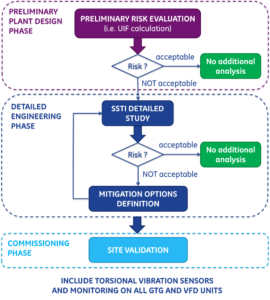

Figure 33: Summary of SSTI practical guidelines for Oil&Gas plants[/caption]
This paper matters because the authors use real site experiences to derive a theory that helps understand the SSTI phenomenon.  Their “simulation results led to a comprehensive understating of the main drivers of this phenomenon leading the authors to provide a set of practical guidelines to properly manage SSTI risk since early plant definition phase. Figure 33 provides a schematic summary of the practical guidelines described in the paper.”
