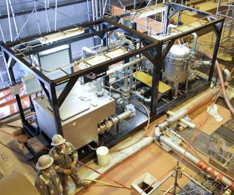

The monitoring of the operation and record keeping is of utmost importance to the effectiveness of any flushing operation.
A dedicated log book for each flushed console should be maintained, and all entries should detail the condition of flushing screens and mode of operation. This log book can be extremely useful in determining the extent of the flushing operation and predicting the remaining flushing time. Samples of screens should be kept for review as the flushing procedure progress.
All unit piping should be flushed at high fluid velocities. This can be accomplished by operating both supply pumps, using a temporary high flow pump and/or installing temporary valves between each supply point and the drain header.
All critical equipment components (bearing, seals, etc.) should be initially bypassed unit supply piping is deemed to be clean.

During the flushing operation, the use of mechanical vibration on piping to break debris loose at flange connections and/or any means of introducing turbulence into the pipe will significantly reduce flushing time. One specific means that has been found to significantly reduce flushing time has been the introduction of clean air or nitrogen into the system during flushing. This makes the system extremely turbulent and gives a scouring action that rapidly cleans all pipes. Care should be taken to only bubble downstream of the filters and only when the bearings are bypassed.

Effective flushing
When one considers that this operation is the last significant pre-commissioning operation prior to the commissioning of new equipment, the tendency to rush and perform less than adequate flushing operations is surprising. It is strongly recommended that anticipated flushing times for each system are discussed frankly with management as early as possible in the project to ensure a clean auxiliary system.
The importance of effective flushing is essential to the final reliability of critical equipment. Therefore, the flushing procedure and acceptance thereof should be number one agenda item in the field pre-commissioning operation. User-contract or concurrence of this procedure should be obtained as soon as possible when commencing field construction. Once the procedure is accepted, supervisory means should be established to accurately monitor and implement this procedure.
A well thought-out flushing procedure, supplemented by equipment specifics, and performed by a dedicated crew of experienced individuals, will result in accurate, effective flushing operations that are accomplished in approximately two to three weeks. Any misconception that a flushing operation can be accomplished in a shorter time is exactly that – a misconception. The effective flushing of equipment will go a long way towards long term, reliable operation of critical equipment.
