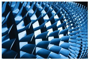

Figure 1: Protective coatings help to increase the efficiency and extend the service life of the gas turbine
