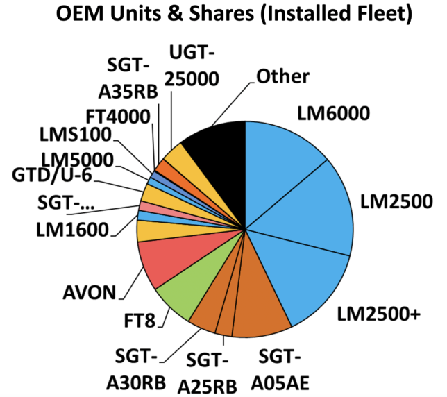

The number of units installed among the various aeroderivative fleets showing the extent of LM2500 family dominance. Courtesy of Dora Partners & McCoy Power Reports.[/caption]

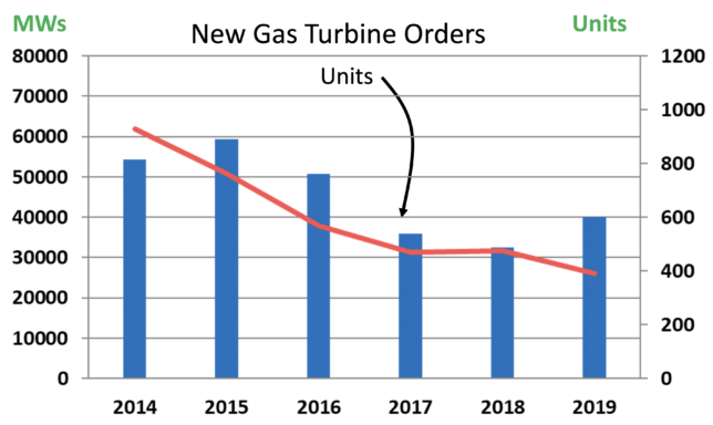

By all indications, it looked like the gas turbine market had finally begun a recovery in 2019. MW orders were up for the first time since 2015. Overall, though, we had seen a 39% drop in MW orders and a 65% slump in unit orders since 2012. Compared to 2018, last year saw a rebound of 23% in MW orders, but a decline of 18% in unit orders. Tony Brough of analyst firm Dora Partners assigns that jump mainly to coal retirements prompting coal-to-gas switching.

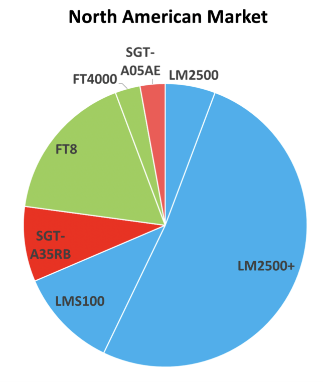

Aeroderivative orders in 2019 for North America. Courtesy of Dora Partners & McCoy Power Reports.[/caption]

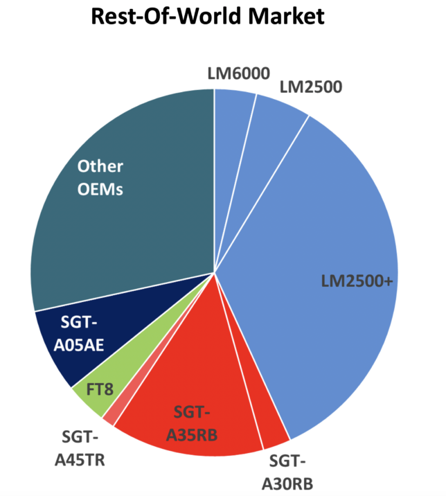

Aeroderivative orders in 2019 from outside of North America. Courtesy of Dora Partners & McCoy Power Reports.[/caption]

2019 appeared to mark a turning a point in terms of increased MW orders after three consecutive down years. But 2020 is now unlikely to continue this trend. The various OEMs have been jockeying for dominance in various parts of the market. GE has historically been number one in MW orders but in 2018, MHPS moved ahead in the large gas turbine space (over 200 MW).
