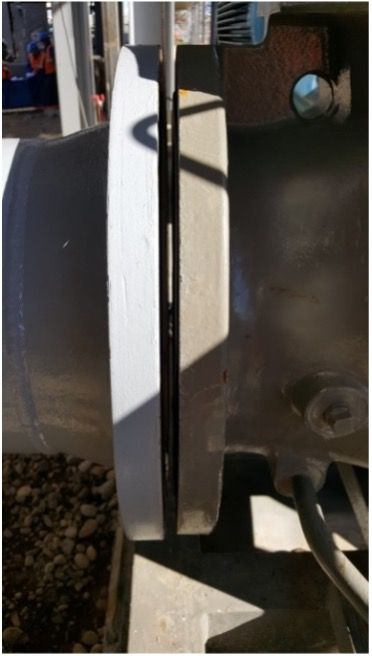

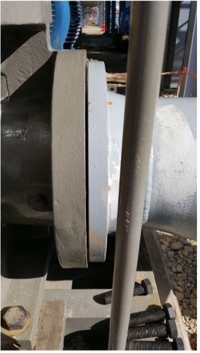

While checking the installation of pumps on a project, we were told that the pump had been aligned and signed off. The contractor executing the work did not have extensive pump installation experience, so we asked to spot-check several pumps. A very quick-and-easy spot check of proper installation for pipe stress is to loosen the bolts on the flanges of the pump when loosened, they should move freely in the mounting holes and no excessive movement of the pipe or pump should be observed. During a check of one of the vertical split-cooling tower pumps, an excessive gap was observed between the 16-inch pipe and the pump flange. When the alignment was rechecked, it was observed to be out of tolerance. An NCR was written, and the realignment and correction of the pipe fit-up were observed. Once the pipe was adjusted and alignment redone, the installation was accepted.
Pump flange after removing bolts. Credit: Fluor

Observations can be made to easily check whether proper installation and alignment steps have been taken. If installation steps are done out of order, this is a clear flag that the complete installation should be checked for compliance.
Pump flange after alignment adjustments. Credit: Fluor

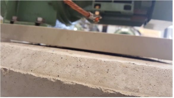

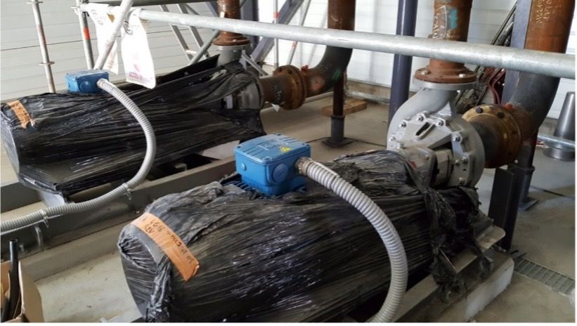

A second example of lessons is when we observed that the pumps were set in place and connected to the pipe with shipping protection still in place—a clear indication that alignment had not been performed before anchoring the pump or connecting to the pipe system. This was flagged and the installation had to be reversed and then redone, leading to rework and delays for the contractor. While this is the correct course of action, this was not immediately caught. Being actively involved in walking a site and observing the actions of construction engineers can help catch these deviations early and minimize the amount of rework created for a project.
Chiller circulation pumps installed with shipping protection still in place. Credit: Fluor
