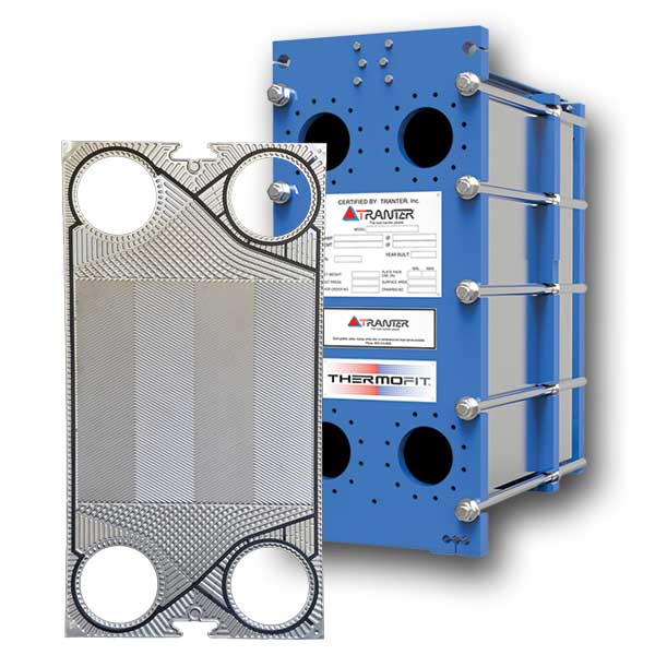

Heat exchangers will be used as vent condensers and for heat recovery between lean and rich solvent. The rich solvent will absorb the CO2 from a gas stream and be heated prior to entering the desorption column, where the CO2 is then separated to form lean solvent. The lean solvent then needs to be cooled down before being reintroduced to the absorber. Tranter’s heat exchangers will condense any evaporated solvent in desorption back into the column.
Tranter’s GT-series ThermoFit plates with the Omniflex plate pattern are exclusively designed for heat recovery duties capable of high NTUs. The design handles high NTUs without excessive pressure drop, making it an ideal component for post-combustion carbon-capture applications using regenerable solvents.
