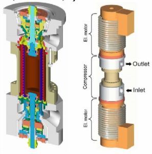

Gullfaks subsea wet gas compressor[/caption]

 The Gullfaks subsea compression, which came on line a few months later than Åsgard, is the first multiphase compression system for wellstream to be installed at the seabed. The Gullfaks subsea installation covers two wet gas compressor units (2 x 5 MW) operated in parallel. The OneSubsea WGC4000 wet gas compressor unit (previously Framo WGC4000) is a contra rotating compressor type with alternating rows of impellers with no static diffusers between them. The design is compact and capable of compressing wet gas.
The unit is directly driven by two variable speed electric motors, which are contra rotating and liquid filled. Power, barrier fluid and lube fluid are supplied by a 15 km umbilical from the Gullfaks C platform. Important qualification of subsea process cooler, electric and vibration monitoring systems have been conducted as part of the  project. The Gullfaks wet gas compressor is working with unprocessed well stream from a gas field, where liquid in form of condensate or water may typically represent 0-5 % of volume, i.e. Gas Volume Fraction (GVF) is 0.95-1. However, the subsea wet gas compressor is design to cover GVF 0-1.
First start up was in winter 2015/2016, and normal production started autumn 2017. The wet gas compression technology will extend the life of Gullfaks for about two years and extract an additional 22 million barrels of oil equivalents. The utilization of subsea compression has an estimated recovery increase from 62 to 74% for the field area involved.
