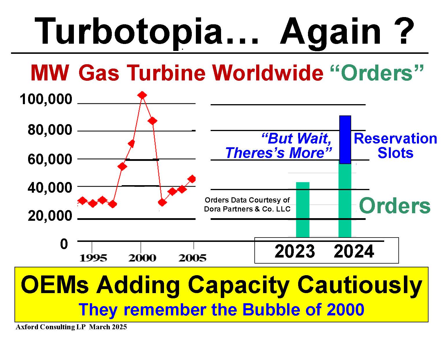

Gas Turbines Gone Wild
As Axford put it: “Gas turbines gone wild.” It’s “Turbotopia” … again but OEMs are cautiously adding capacity, remembering the 2000 bubble. New orders will now ship in 2027, 2028, and 2029, with gas turbine and engineering, procurement, and construction (EPC) prices up sharply.
“We completed a modern combined cycle in 2022 for $785 per KW,” said John W. Ketchum, CEO of NextEra. “A new build for 2030 commercial operation will cost $2,400 per KW.”
According to Dora Partners & Co., global gas turbine MW orders were upwards of 40,000 in 2023 and around 60,000 MW in 2024 with reservations for more than 80,000 MW (FIGURE 1).
MW gas turbine worldwide orders; credit: Axford Turbine Consulting
