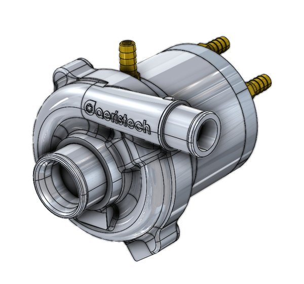

Caption: CAD rendering of the 6kW oil-free compressor model. Credit: Aeristech.

The 6kW oil-free compressor model delivers a pressure ratio of 1.9 at 160,000 RPM and weighs less than 4kg. Its high-speed motor and compact design offer a power-dense solution. The 10kW oil-free compressor provides a pressure ratio of 2.5 at 115,000 RPM, weighs 5.4kg, and accepts a wide range of input voltages (260-700V), allowing direct power in fuel cell applications without needing a separate DC/DC converter. The 25kW oil-free compressor features a pressure ratio of 3.0 at 95,000 RPM and weighs less than 10kg, providing a compact solution for higher power, continuous operation.
