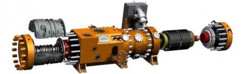

MAN’s Business Unit Oil & Gas has supplied integrated turbocompressor systems for 25 years. The most significant aspects of this machine are the use of a high-speed motor and active magnetic bearings. There is no need for dynamic seals which makes the compressor system hermetically sealed and as a consequence offers many advantages. The absence of the dry gas seal system and of the complete oil system reduces the complexity and this leads to the improved system reliability. The required footprint significantly shrinks by 60 percent and weight on the compressor installation drops by 30 percent in mass compared to traditional compressor designs.
The order for Ivar Aasen comprises a multi-stage radial compressor (1x100 percent) arranged in tandem configuration around a centrally positioned 9.5 megawatts high-speed electrical motor.
